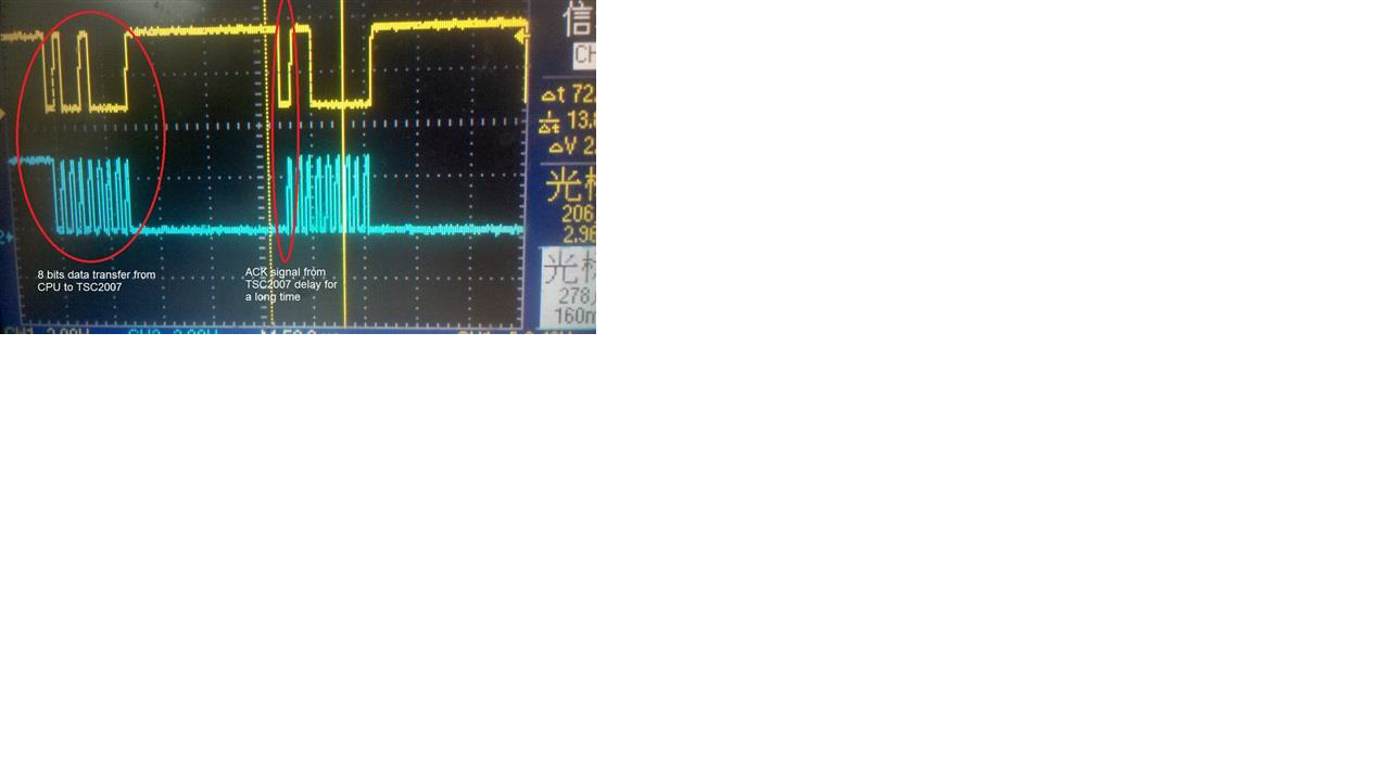

Hi expert:
We connect J6 I2c with DS90UH925, the touch panel connect to J6 through DS90UH925/UH926 I2C interface.
The touch panel some time will stop work at 400KHz mode. We find that it maybe have relation ship with I2C stretch feature.
(e2e.ti.com/.../465109)
We find that some engineer has ask Vayu whether support I2C stretch feature but we did not find the confirmed information.
Could you please tell us whether now J6 support I2C stretch feature?
At TRM and dirver at linux kernel/driver/i2c/buses/i2c-omap.c we did not find the work around setting about I2C stretch.
Best Regards!
Han Tao
Below are DS90UB925 engineer provided capture wave at i2C interface, slave device pull SCL low till next bit ready.
