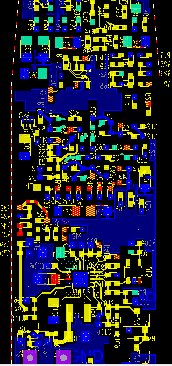

Hello!
When we can see at top DDR K4T1G164QF-BCE7, then DSP and then power components.
The bottom of the same part of the board:
Hello!
Yeah, I reviewed and compared some designs with this DSP and didn't find some critical mistakes at our design..
Thank you for your reply!
RandyP said:Since all of your problems showed up on a few boards, does that mean that other boards did work correctly? Have you been able to get everything running on at least 1 board out of your 20?
Under the assumption that some boards work okay, then we know that your schematics do not have any major problems. That would be good to know for sure. And the same for your layout, if some boards work correctly.
Yes, we have couple of boards that works good. Even I can tell more - almost all boards works well when they run at our laboratory. Majority of failure happens at customers usage.
RandyP said:There are some very thin lines of the left edge of the schematics along the DSP. That could be tough for your board shop to manufacture, and they might be having difficulties with placing the components reliably because of the small board size with the components so close to the edge.
Those lines are lines for the 2 crystals of the DSP.
RandyP said:All of your problems that are fixed by replacing the components could easily be related to the board build and not directly to the components themselves. To verify that, I would try some of the parts you have removed on another board that has had problems. Or even remove a part on a failing board and replace it on the same board, which simply means reworking that board with the same components.
The problem with this that the main component that no work well is DSP and after replacing it is no possible to reassemble removed DSP to other board.. This is because of our components placing factory limitations.
RandyP said:I am certainly not a board design expert, but having your power components close to the DSP should not be a problem. If the power components were generating noise, the distance would not have a lot of effect on that noise reaching the DSP. The IR voltage drop will be reduced with shorter distances, which would be good. But the extra noise you are showing of +/- 70mV would not be related to that distance, only to the power components and filters around them. And even though that is outside the spec, it would not tend to cause this much trouble. It does need to be solved or fixed, but there must be other explanations for the problems you are having than simply power supply noise.
Yeah we also thought that is no need to be so critical but anyway wanted to ensure this..
RandyP said:Have you confirmed all the power/clock/reset sequencing is being done correctly?
Power/reset sequencing was checked and confirmed. And clock sequencing - I didn't saw that this DSP need to have some of it. Is it need? The clocks seems a little distorted but is this is the problem for the design?

Shevchenko,
Shevchenko Maxim said:almost all boards works well when they run at our laboratory. Majority of failure happens at customers usage.
From what you have observed with the tests in your laboratory compared with the customer usage, is there a big difference in what programs/applications are run on the DSP? Or is the environment the biggest difference, such as vibration, temperature, outside electrical noise?
Shevchenko Maxim said:Those lines are lines for the 2 crystals of the DSP.
The chance for noise and cross-talk between long thin lines would make me nervous, especially on high-impedance lines to a crystal. I expect you have board analysis that shows it to be okay, but something to keep in mind. Problems here would tend to cause instability in the clock and might be more likely to show erratic behavior than predictable failures.
Shevchenko Maxim said:The problem with this that the main component that no work well is DSP and after replacing it is no possible to reassemble removed DSP to other board.. This is because of our components placing factory limitations.
There are ways to re-ball the DSP. I have heard of this with other customers and with our FA department. There could be a contractor in your area who can do that, but it might not be worth the trouble or expense. It is a useful way to narrow down the problem. But I can assure you that our devices are well tested before they leave our factory, so faulty DSPs are rare.
Shevchenko Maxim said:Power/reset sequencing was checked and confirmed. And clock sequencing - I didn't saw that this DSP need to have some of it. Is it need? The clocks seems a little distorted but is this is the problem for the design?
The requirements are called out in the datasheet. There is a specific order for the several power supplies, as you have already checked against. For the clock, it needs to be stable a certain time before RESET and TRST can be released. This is not as complex as some of our devices, so my terminology may be a bit strong to call it 'sequencing', but the clocks do have to be stable before releasing RESET.
Is it true that the boards work under laboratory testing first, then they go to the customer for testing and some fail there? And then do they continue to fail your original tests when you bring them back to your laboratory? That is how I read you comments above. Do you have any observations to share about the condition of the boards when returned? Or about how they are used at the customer's site?

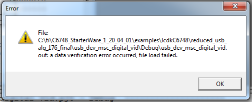

Hello!
Is someone have new thoughts about our issue?
Which tests can I do to my board except standard board tests to determine what is the problem?

One way to rule out clock noise or power supply noise as the cause would be to disable the on-board clock and / or the power supplies and to wire in bench supplies for these supply rails. if this resolves a board that has the problems, this proves that the power and / or clock implementation is the cause. Please let us know the results of this test.
Tom
We removed power components and insert external power to DSP voltages. At the board we still see the problematic ripple when on output of power supplies it is ok.
Shevchenko,
This appear to indicate that your decoupling implementation is not adequate. Are you using small capacitors with low ESL ? Do you have the sufficient quantity of the recommended values? Are the caps with short and wide traces resulting in low PCB inductance? You should be able to modify your board to get the power supply noise down to the required level. Note that the wires from the bench supplies need to be as short as possible to minimize inductance and a large cap may need to be added at the connection point for these wires.
You did not indicate whether use of the bench supplies affected the system issue reported (picture with yellow hue). Was there any effect?
Tom
We used quantities, recommended values and kind of capacitors as we saw at one of evaluation boards, we also checked it with decoupling recommendations of TI. The traces are short as possible.
We didn't try to make bench supplies to board with picture with yellow hue

The point of this exercise is to determine the contributing factors to the yellow hue problem. Please rework one of these boards to operate with the bench supplies to see if this resolves the reported problem.
Tom
Shevchenko,
Randy has indicated the probable cause of device damage. You can change the circuitry on the debug board to prevent it from driving the pins on the DSP before it is powered. Emulators and debuggers routinely monitor the TVD (target voltage detect) pin and do not drive ant pins until the target is powered.
Tom
Hello!
Yes, we thought about this possibility. So lately we changed that Debug Adapter Board buffers, JTAG and other components that driving signals to DSP - get their 3.3V from the Main Board and no from external source. For now it looks that it helped. 4 boards looked to work fine and no get damaged. But need to verify this with more. We send damaged boards to DSP rework, will test it and find out is this was the issue.
