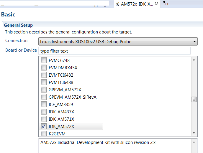

  • Hi Paula ,
    I tried running Ecmaster.out using JTAG and seen the output logs in the CCS console.
    I followed the below steps to see the output on the console .
    Create a target configuration
    (a) Navigate to View→Target Configuration.
    (b) Right-click New Target Configuration
    (c) Create a file name (for example, AM572x_IDK.ccxml)
    (d) Set the connection to XDS100v2 USB Emulator for the onboard JTAG
    NOTE: The onboard JTAG is slow. If possible, TI recommends using an external JTAG such as
    a Spectrum Digital XDS560v2 STM USB.
    (e) Set the board or device to AM572x
    (f) Click Target Configuration and select Cortex-A15_0
    (g) Enter the initialization script as follows: ..\..\emulation\boards\am572x\gel\idk_am572x.gel
    (h) Click the Save button
    (i) Right-click AM572x_IDK.ccxml to launch the configuration
    (j) Right-click CortexA15_0 to connect to the target
    (k) Click Scripts→Default
    (l) Click OnTargetConnect_API
    (m) Click on Load Program, and then click Browse Project
    (n) Click EcMasterDemo
    (o) Click on Debug or Release
    (p) Click EcMasterDemo.out
    (q) Click the Resume button
    I loaded the program of Ecmasterdemo.out of DEBUG configuration. After doing this control going to the main function then it is stopping nothing is displayed on the console.

  • Hi Swarna, we could try to debug this, but really it is strange as it works for me.. Could you please have a fresh setup, meaning downloading again from acontis "EC-Master-ICSS-V2.9.0.06-SYSBIOS_AM57x-Protected" and "EC-Master-V2.9.0.06-SYSBIOS_AM57x-Protected" and then apply the changes suggested in my previous post?
    Thank you,
    Paula
