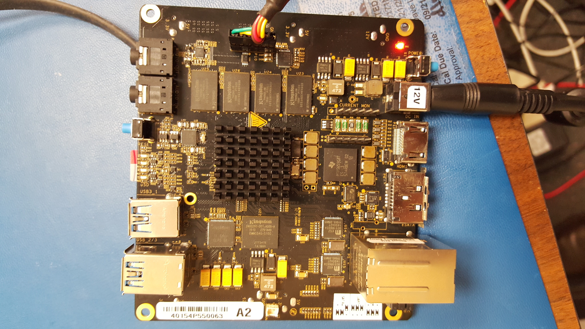

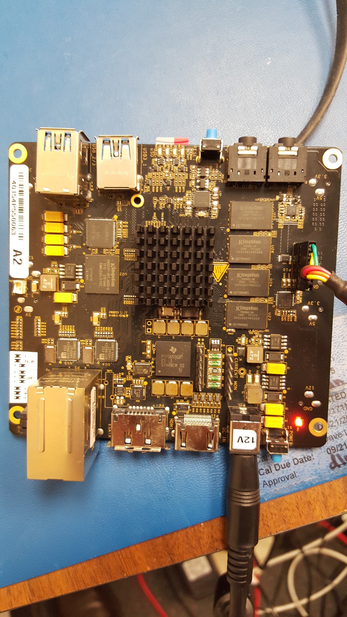

    But given that LED blinking worked on your end, I suspect some setup issue. E.g, can you detect the UART cable plug/unplug in your host PC? is it 115200, 8-N-1 setting? Can you try a different UART cable or USB port in host PC? Or is the cable orientation correct? See the attached picture.

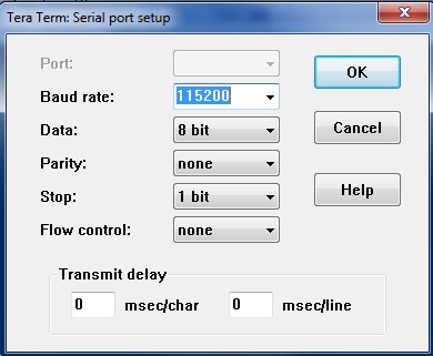

    TeraTerm configure for 115200, 8-N-1 setting and orientation of cable is also correct (same as the pic shared by you).
