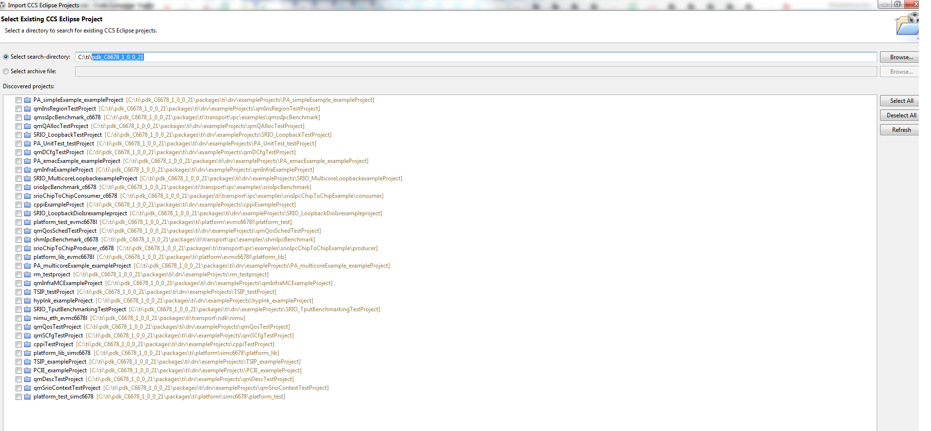

    Thanks for the quick response.  We are unable to locate NIMU_emacExample_EVMC6678C66BiosExampleProject.
    We have been switching back and forth to different CCS version to get hold of the examples.
    We have installed the MCSDK from the DVD which we received with the EVM.
    The PDK version is pdk_C6678_1_0_0_21.
    The example project which you have mentioned could not be found in the list.
    Is that possible to attach tar archive of the example project?
    Rams
  • Rams,
    The MCSDK was already obsolete. Please get the latest Processor SDK RTOS from software-dl.ti.com/.../index_FDS.html
    Regards, Eric
