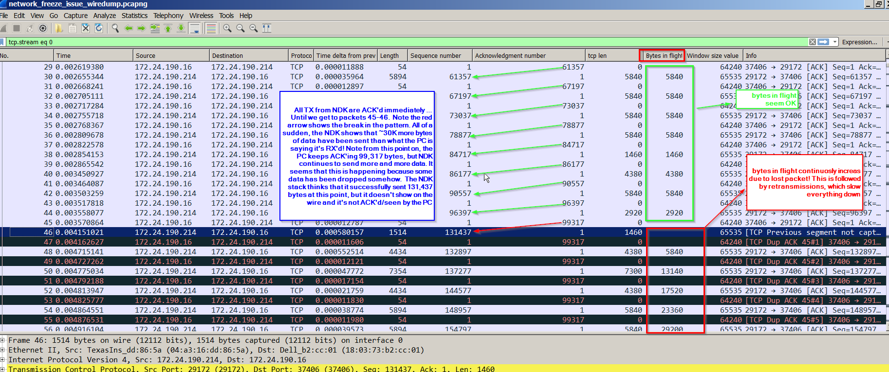

Hello All,
I am running network transmit with TCP/IP on TDA2xx device using TI NDK.\
I am seeing my throughput doesn't cross 16Mbps even though my CPU load is just 7% (Cortex A15 running at 1GHz).
Below is my NDK configuration:
NdkConfigGlobal.lowTaskStackSize = 8192;
NdkConfigGlobal.normTaskStackSize = 8192;
NdkConfigGlobal.highTaskStackSize = 8192;
NdkConfigGlobal.ndkThreadStackSize = 8192;
NdkConfigGlobal.pktSizeFrameBuf = 1536;
NdkConfigGlobal.pktNumFrameBufs = 192*8;
NdkConfigGlobal.memRawPageCount = 16*8;
Tcp.transmitBufSize = 256*1024;
Tcp.receiveBufSize = 256*1024;
Tcp.receiveBufLimit = 256*1024;
Also i am not setting any options for recv and send window size via setsockopt.
