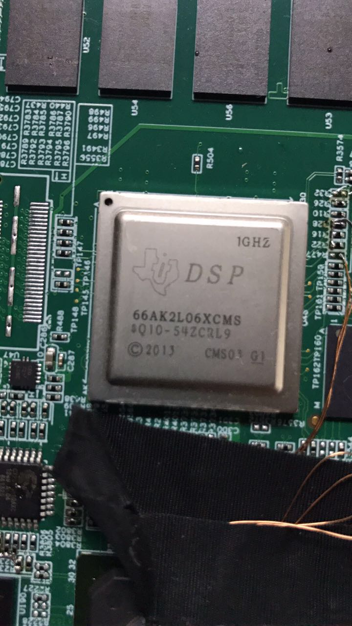

66AK2L06: CPU1: failed to come online on 66AK2L06.
Part Number: 66AK2L06
Other Parts Discussed in Thread: TCI6630K2L
Hi all,
I have worked on booting up secondary ARM core(aka CPU1) on 66AK2L06 almost two weeks with failure all the time.
I am using ti-processor-sdk-linux-k2l-evm-03.03.00.04(and also try ti-processor-sdk-linux-k2l-evm-03.02.00.05).
I also try prebuilt-images but still got failure.
I trace the secondary core startup flow.
Firstly, the CPU0 will call psci function in boot-monitor to power on CPU1.
Secondary, the CPU1 will first executes some code in boot-monitor  and then executes function secondary_startup in arch/arm/kernel/head.S
It seems that secondary_startup wouldn't be executed on CPU1.
I add "b __error_p" to this function as the first instruction but there isn't any error information on UART0 and the kernel will boot up.
If I add "b __error_p" to entry stext as the first instruction, it will display error information as expected(which is executed by CPU0) and kernel will stop booting up.
I have checked the boot-monitor has power on CPU1 with success.
I don't know why the  secondary_startup doesn't be executed by CPU1.
Maybe the CPU1 was hang all the time, so it doesn't execute any code both in boot-monitor or kernel.
I have checked power supply and its sequencing. There isn't any problem.
I upload my u-boot setting, kernel boot log, dts file(recovery from dtb) and kernel config for checking.

  • I upload the chip image for checking SoC version and part number.
  • Hi, Jason,
    It seems that your SoC is rev 1.0. I don't think DEVSTAT bits matter. In Tony's first link, it seems only related to K2HK EVM. In thre pre-built image folder, there is only K2hk birnary file provide. That says it doesn't apply to K2E/L. In the second link, customer didn't provide more feedback, but just verified the answer. That give me the impression that customer didn't reset the u-boot environment variables after u-boot upgrade. I can't find a pg2.0 EVM, but don't think it matters either. The TI EVM has the same rev as yours. I can't explain why we don't see the issue on TI EVM, but yours. Without reproducing the issue at TI, I can't narrow down the cause.
