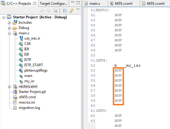

    I am studying this example you provide. I notice that in vectors.asm you map INT4 to my_isr() like this:
    INT4:
                            b          _my_isr
                            NOP
                            NOP
                            NOP
                            NOP
                            NOP
                            NOP
                            NOP

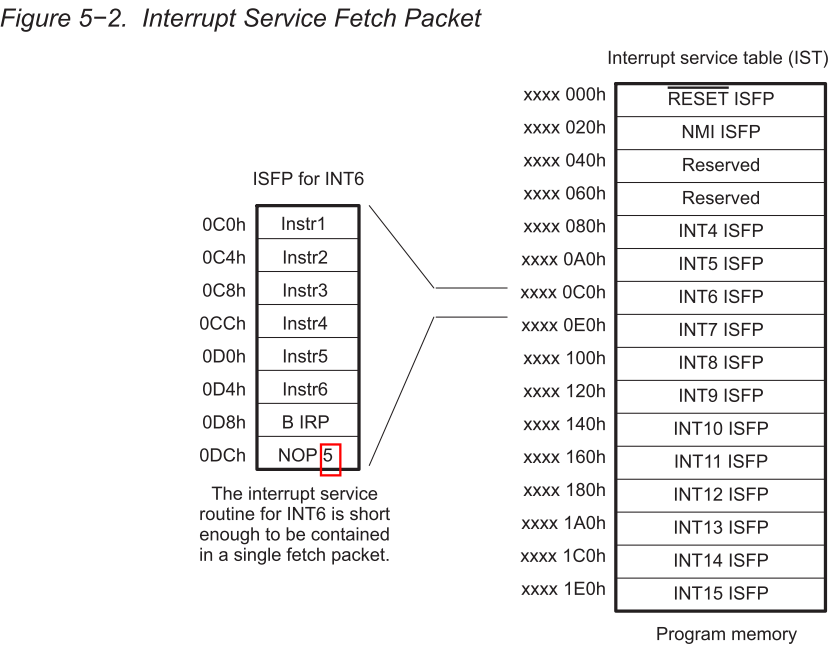

    You are all using “NOP”s. But according to SPRU732g, page 5-7, Fig. 5-2 Interrupt Service Fetch Packet, there needs to be an “NOP 5” after interrupt return pointer instruction (B IRP). The reason for the insertion of “NOP 5”, according to this document, was that
    “there are five delay slots between the execution of the branch and execution of the target code”.
    I have a question:
    If my understanding is correct, the “b” preceding “_my_isr” here is also a branching in the sense that it “jump”s to the my_isr() function.
    1.    There is no “NOP 5” in your program, is it because of the difference between my_isr(), which is a user written routine, and IRP, which is an internal CPU instruction?
    2.    Or is it because that there are 7 NOPs after “b   _my_isr”, which is more than the “five delay slots”, so that there is no need for “NOP 5”?
    Sincerely,
    Zheng
    INT4:
                            b          _my_isr
                            NOP
                            NOP
                            NOP
                            NOP
                            NOP
                            NOP
                            NOP
    I should mention that the code above was just a quick hack to get things working.  Although it is functionally correct it is limited from the perspective that it is using a relative branch.  This limits the placement of your ISR relative to the vector table.  The "proper" way to do this is with an absolute branch which is a little more complicated because it requires a register.  Here's how it should look:
                        stw b0,*b15--[2]        ; temp save b0 on stack
                        mvkl _my_isr,b0        ; load destination address to b0
                        mvkh _my_isr,b0
                        b b0                    ; start branch to destination
                        ldw *++b15[2],b0        ; restore b0 register
                        nop 2                   ; fill 2 of b0 restore delay slots
                        nop                     ; fill delay slot, pad packet
    After executing a branch instruction the CPU will execute the following 5 instructions.  So if you put a "NOP 5" after the branch instruction it will execute 5 NOPs.  Having 5 separate NOP instructions accomplishes the same thing.  In my case I have 7 total NOP instructions.  Only 5 would actually be executed during an ISR.  The other 2 are there because each interrupt service fetch packet is composed of 8 instructions.
    Correct.
