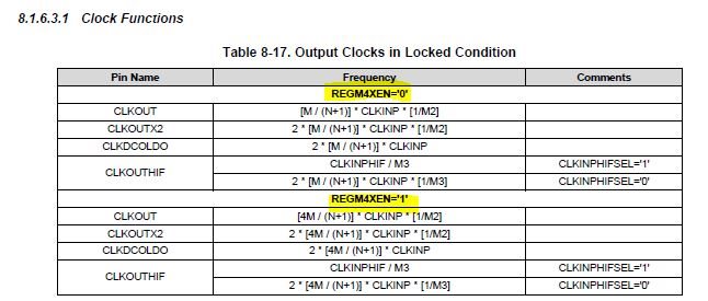

Hi all,
Is there a register to set the following REGM4XEN?
