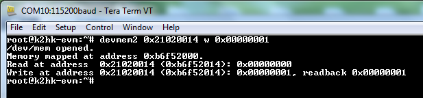

    One possibility is to use devmem2 command from linux console. The command should be executed as:
    devmem2 0x21800014 ===> this accesses Reset Command Register for PCIe 0 config
    devmem2 0x21020014 ===> this accesses Reset Command Register for PCIe 1 config

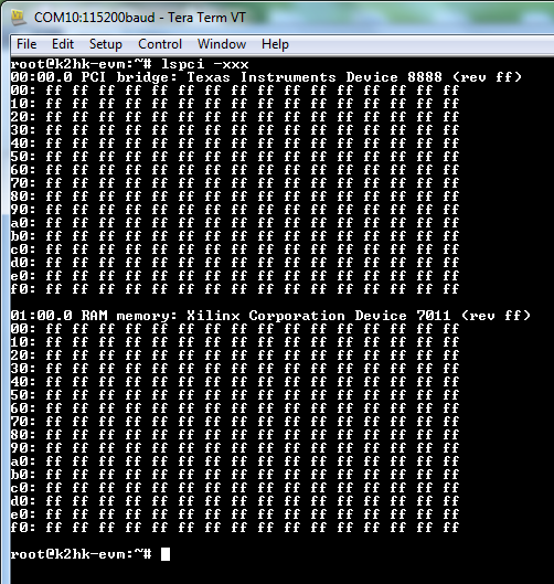

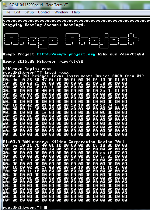

  • I tried using the first suggested solution, it does not seem to work, this is the configuration space when everything is working fine.
    I simulate the link drop condition by resetting the Picozed board, and the configuration space seems to be corrupted afterwards, as you can see in the picture below.
    I tried the solution suggested by you, but the configuration space is still corrupted. I tried the following.
    The configuration space is still same,
    Any ideas whats wrong with it?

    root@k2hk-evm:~# lspci -xxx
    00:00.0 PCI bridge: Texas Instruments Device 8888 (rev ff)
    00: ff ff ff ff ff ff ff ff ff ff ff ff ff ff ff ff
    10: ff ff ff ff ff ff ff ff ff ff ff ff ff ff ff ff
    20: ff ff ff ff ff ff ff ff ff ff ff ff ff ff ff ff
    30: ff ff ff ff ff ff ff ff ff ff ff ff ff ff ff ff
    40: ff ff ff ff ff ff ff ff ff ff ff ff ff ff ff ff
    50: ff ff ff ff ff ff ff ff ff ff ff ff ff ff ff ff
    60: ff ff ff ff ff ff ff ff ff ff ff ff ff ff ff ff
    70: ff ff ff ff ff ff ff ff ff ff ff ff ff ff ff ff
    80: ff ff ff ff ff ff ff ff ff ff ff ff ff ff ff ff
    90: ff ff ff ff ff ff ff ff ff ff ff ff ff ff ff ff
    a0: ff ff ff ff ff ff ff ff ff ff ff ff ff ff ff ff
    b0: ff ff ff ff ff ff ff ff ff ff ff ff ff ff ff ff
    c0: ff ff ff ff ff ff ff ff ff ff ff ff ff ff ff ff
    d0: ff ff ff ff ff ff ff ff ff ff ff ff ff ff ff ff
    e0: ff ff ff ff ff ff ff ff ff ff ff ff ff ff ff ff
    f0: ff ff ff ff ff ff ff ff ff ff ff ff ff ff ff ff
    01:00.0 RAM memory: Xilinx Corporation Device 7011 (rev ff)
  • I found a way while playing around with the application registers, when i disable and re enable the LTSSM_EN bit in the Command Status Register, i.e CMD_STATUS, the configuration space for the PCI bridge seems to be re configured, however the Configuration space for the End point, picozed in this case contains all zeros, any ideas that can help me configure that as well?
    i am sharing the console commands and results below.
    root@k2hk-evm:~# devmem2 0x21800004 w 0x00000006
    /dev/mem opened.
    Memory mapped at address 0xb6fb1000.
    Read at address 0x21800004 (0xb6fb1004): 0x00000006
    Write at address 0x21800004 (0xb6fb1004): 0x00000006, readback 0x00000006
    root@k2hk-evm:~# devmem2 0x21800004 w 0x00000007
    /dev/mem opened.
    Memory mapped at address 0xb6fc5000.
    Read at address 0x21800004 (0xb6fc5004): 0x00000006
    Write at address 0x21800004 (0xb6fc5004): 0x00000007, readback 0x00000007
    00:00.0 PCI bridge: Texas Instruments Device 8888 (rev 01)
    00: 4c 10 88 88 47 01 10 00 01 00 04 06 10 00 01 00
    10: 00 00 80 21 08 00 00 80 00 01 01 00 f0 00 00 00
    20: 00 50 00 50 f0 ff 00 00 00 00 00 00 00 00 00 00
    30: 00 00 00 00 40 00 00 00 00 00 00 00 3c 01 01 00
    40: 01 50 03 00 00 00 00 00 00 00 00 00 00 00 00 00
    50: 05 70 80 00 00 00 00 00 00 00 00 00 00 00 00 00
    60: 00 00 00 00 00 00 00 00 00 00 00 00 00 00 00 00
    70: 10 00 42 00 01 80 00 00 10 18 05 00 22 34 13 00
    80: 48 00 11 30 40 00 00 00 c0 03 40 00 00 00 00 00
    90: 00 00 00 00 1f 00 00 00 00 00 00 00 06 00 00 00
    a0: 02 00 01 00 00 00 00 00 00 00 00 00 00 00 00 00
    b0: 00 00 00 00 00 00 00 00 00 00 00 00 00 00 00 00
    c0: 00 00 00 00 00 00 00 00 00 00 00 00 00 00 00 00
    d0: 00 00 00 00 00 00 00 00 00 00 00 00 00 00 00 00
    e0: 00 00 00 00 00 00 00 00 00 00 00 00 00 00 00 00
    f0: 00 00 00 00 00 00 00 00 00 00 00 00 00 00 00 00
    00: 00 00 00 00 00 00 00 00 00 00 00 00 00 00 00 00
    10: 00 00 00 00 00 00 00 00 00 00 00 00 00 00 00 00
    20: 00 00 00 00 00 00 00 00 00 00 00 00 00 00 00 00
    30: 00 00 00 00 00 00 00 00 00 00 00 00 00 00 00 00
    40: 00 00 00 00 00 00 00 00 00 00 00 00 00 00 00 00
    50: 00 00 00 00 00 00 00 00 00 00 00 00 00 00 00 00
    70: 00 00 00 00 00 00 00 00 00 00 00 00 00 00 00 00
    80: 00 00 00 00 00 00 00 00 00 00 00 00 00 00 00 00
    90: 00 00 00 00 00 00 00 00 00 00 00 00 00 00 00 00
    a0: 00 00 00 00 00 00 00 00 00 00 00 00 00 00 00 00
