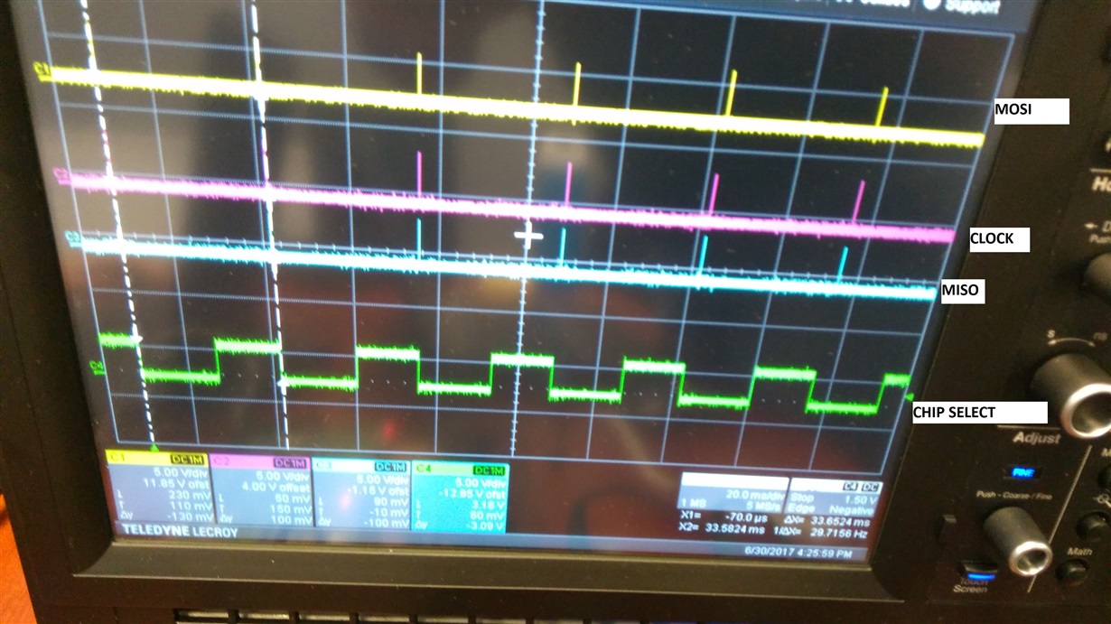

Hello Gurus,
Im working on a custom board based on AM4377.
Im facing an issue related to SPI chip select timing where in the chip select stays low and high for a longer duration.
I would like to have the chip select go high post transmitting and receiving 32 bits of data(32 clock ticks) to and from the FPGA slave device.(Apart from t-lead and t-lag delays.)
The SPI enable(assertion) is automated.
I tried working on various time control of chip select toggle(TCS0) without any luck and the duration remains the same.
Chip Select Time Control This
2-bits field defines the number of interface clock cycles between CS
toggling and first or last edge of SPI clock.
0h (R/W) = 0.5 clock cycle
1h (R/W) = 1.5 clock cycle
2h (R/W) = 2.5 clock cycle
3h (R/W) = 3.5 clock cycle
The chip select duration remains the same for 0.5, 1.5, 2.5 and 3.5 clock cycles.
Following picture below gives you a better idea of the chip select behavior with respect to clock, MISO and MOSI.
So, could you please help me with a better timing control of the chip select?
