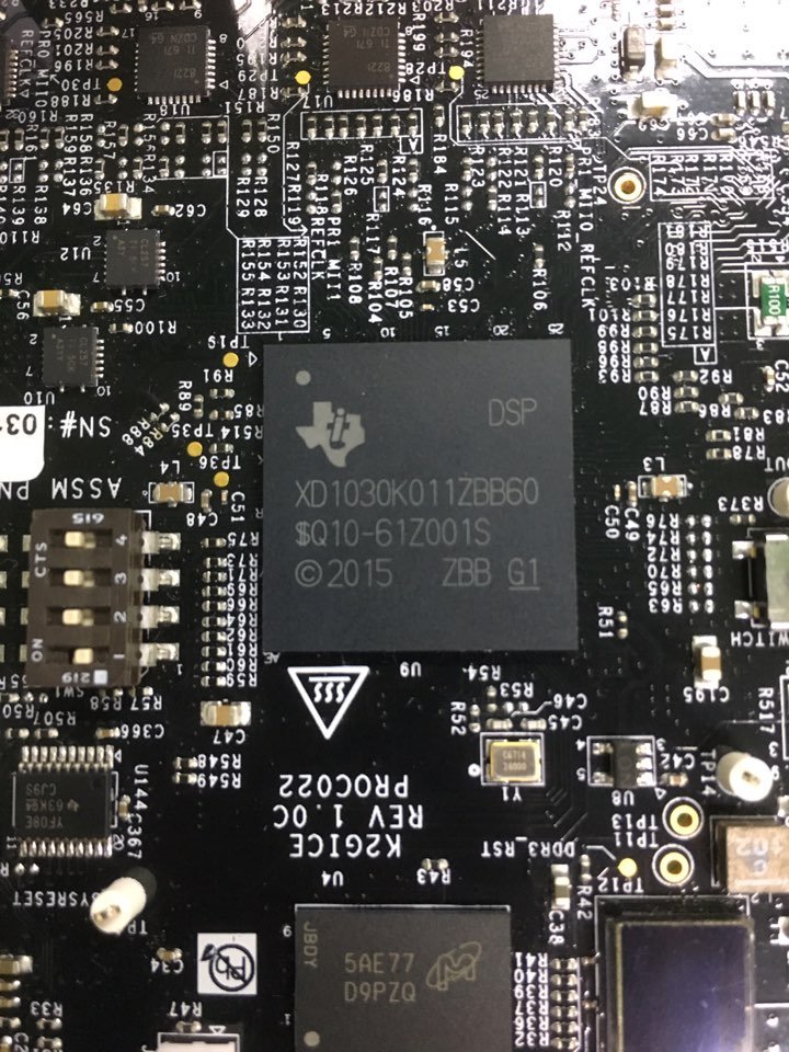

    My K2GICE's cpu part name is XD1030K011ZBB60.
    Is it same with X66AK2G02ZBB60? Or any different?
