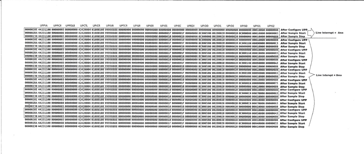

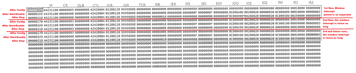

  • Thanks Yordan, Here is more information:
    I am configuring the UPP and it's DMA in the same manner every time. I have captured the UPP register values (below) for 3 consecutive runs.  In the first run, the UPP behaves as expected where I toggle a test point to show when the UPP DMA ISR is being serviced.  The period of the output waveform is as expected based on 40 lines at 32 bytes per line at around 4ms
    The next iteration, even though I am configuring the DMA for 40 lines of 32 bytes per line (as in the first run), the window interrupt period doubles to around 8ms, This behavior continues until I cycle power, where we would see the first run as expected and double the window interrupt time period on subsequent runs.
    The image below indicates the settings being used for each consecutive iteration.  I capture the UPP register values after configuring, after I enable the UPP, and after I stop the UPP ( 3 sets of value per run). Please note I truncated the UPP prefix on the register labels...IE UPPIA is just IA.
    There are clues here (i'm assuming) in the status registers (IS0, IS1, IS2).  I'm just unsure of what to make of them right now.  I think I need to reset the DMA after each run to start with a clean slate for every UPP run, but I don't see any information regarding on how to do this.

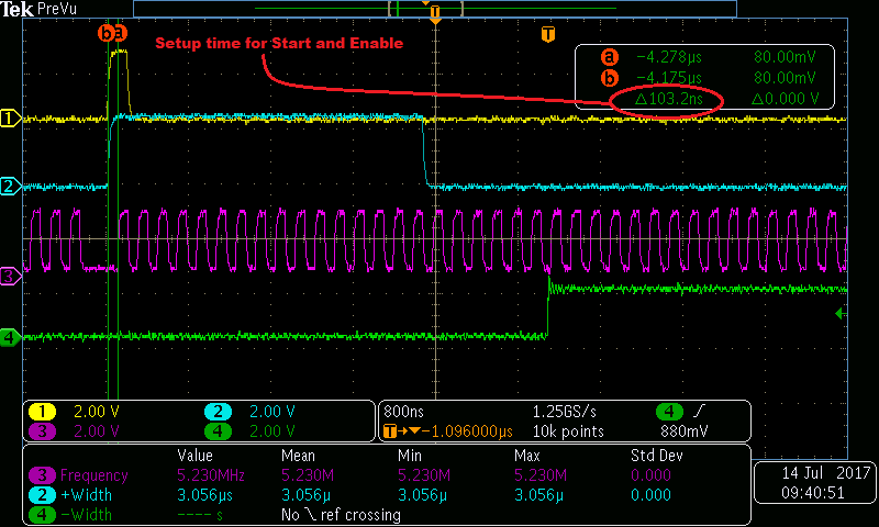

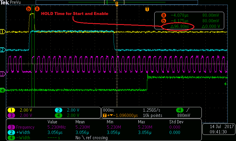

    Here' is a capture that illustrates the "missed" START pulse:
    Here is an Illustration of the setup and hold times for the Start and Enable signals.
    1. There is plenty of time allotted for each signal in each case.
    2. There is a slight discontinuity in the clock at the start/enable assertions but it seems like that shouldn't affect state machine.  There are a significant number of clocks prior to this. This discontinuity is a factor of the different "sample rates" not having a nice integer divide to get the data out of the UPP.
    3. The Start is High for 1 complete clock cycle
    4. The Enable Signal is High for 16 clock pulses ( we are configuring the systems for 16 bit interface, 32 bytes per line, which  yields 32 bytes / 2 bytes (16 bits) per upp clock = 16 clocks.
