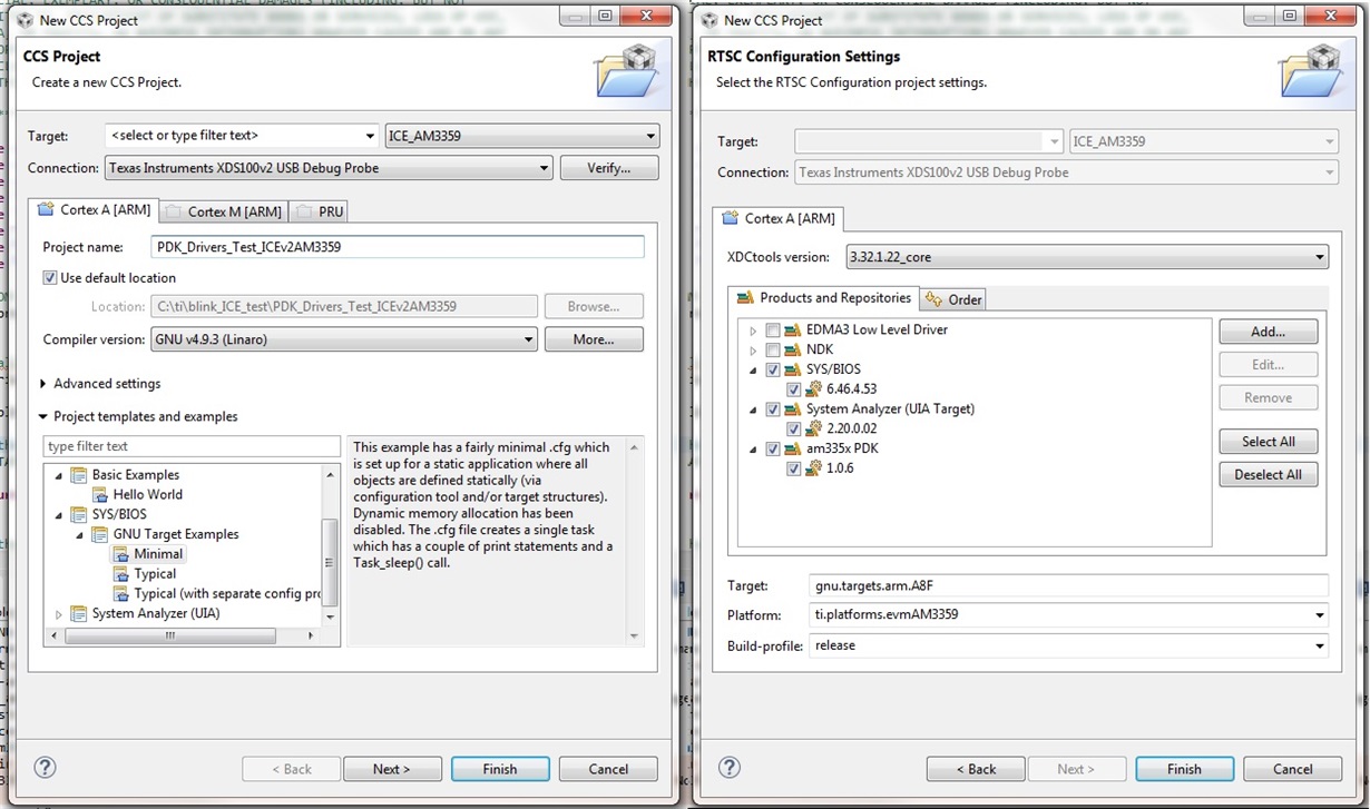

I am new with code composer, sitara and TI-RTOS. In order to learn how to configure the so and sitara peripherials I want to create a basic program to write a message throw my ICE v2 AM335x UART.
I took the SYS/BIOS minimal example as starting piont of my project. Project configuration in ccs6:
From the very begining I had loads of problems to add peripherial drivers to the project. Eventhough I included the header files mentioned in the RTOS guide I was unable to compile due to 'undefined reference to Board_init' error.
Since there is no so many information about TI-RTOS and sitara configuration it took me some time to figure out I had to add references to the drivers in the .cfg file. Not only to the ones mentioned in the guide (board and UART), but also to OSAL and CSL packages. I found this by reading post!! No workshop or guide mention this!!
After loading those packages I still having problems to compile because of some I2C and UART 'undefined references', at some point they got solved. To be honest I am not sure how... Could be the order I add the packages to the .cfg file??
Afer reading this post I added suport to MMU and cache memory.
So now mi .cfg file looks like this:

Now it compiles but it still not working. I have tried to debug the problem but when the main function calls Board_init it gives me an error and jumt to syscalls.c file. I have tried to debug inside the Board_init function but I cannot set any brakepoint there, also when I want to go to definition it takes me to the header file and not to the icev2AM335x.c file where it is defined.
I guess It has something to do with my project configuration so I post here the build output, mi main.c file and the error it gives me. Please help me finding what I am doing wrong.
This is the build output I get when it successfully compiles:

This is my main.c file:
 *  ======== main.c ========
// ----- Default includes
#include <xdc/std.h>
#include <xdc/runtime/System.h>
#include <ti/sysbios/BIOS.h>
#include <ti/sysbios/knl/Task.h>
#include "stdio.h"
#include "stdint.h"
#include "stdlib.h"
#include "string.h"
// ----- My includes
// Board driver
#include <ti/board/board.h>
// UART drivers
#include <ti/drv/uart/UART.h>
#include <ti/drv/uart/UART_stdio.h>
void UartWriteSomething (void){
UART_printf("I AM ALIVE");
 *  ======== main ========
Int main()
     * use ROV->SysMin to view the characters in the circular buffer
    System_printf("enter main()\n");
    /* Setting up for pinmux and uart */
    Board_initCfg boardCfg;
    boardCfg = BOARD_INIT_MODULE_CLOCK | BOARD_INIT_PINMUX_CONFIG | BOARD_INIT_UART_STDIO;
    Board_init(boardCfg);
    BIOS_start();    /* does not return */
    return(0);
This is the ROV report when I run the program in my board:
,emaphoreP_tirtos.c", line 131: error {id:0x10000, args:[0x800157a4, 0x800157a4]}
 xdc.runtime.Error.raise: terminating execution
Any idea of what is happening???

  • Thanks for your quick response.
    I have already seen those trainings and examples you mention... They are much complex than what I am triying to achieve so I am not able to decide which modules are necessary for my application (just to write a line trought the UART).
    Anyways my program crashes at Board_init  call, which is the first thing it does, so I cannot reach the UART specific functions... it calls _exit(int code) function in syscalls.c and abort execution
    Could you please post a .cfg file with the minimal modules necessary to make Board_init  function work???
    Do I have to modify any of my board specific files?
    Something special I should take into account??
    Any register to monitorize that could give me a hint of whats happening??
    Is it necessary to define Cache and MMU configuration in order to use the board or UART functions??
    I am sure I am making a stupid mistake somewhere but I am completely lost...

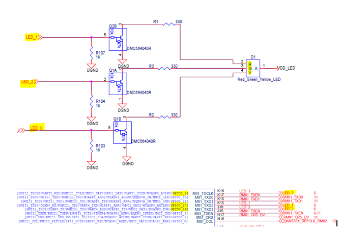

    Sorry for the late reply, was doing some research on the questions before responding.
    The code isn't very clear, so I will try and clarify. The +1 is due to the driver APIs being one-based. You can see that at C:\ti\pdk_am335x_1_0_7\packages\ti\drv\gpio\src\v1\GPIO_v1.c where there is a -1U in hwAttrs. This is an artifact of code brought in from other platforms such as AM57x. I have filed a ticket to get any references to AM57x in the AM335x source code cleaned-up as this is confusing.
    You will notice that 1 pin is configured as input and the other as output. No, its not required that you configure the same pin as input and output. The reason for configuring 1 of the pins as input is for the interrupt mechanism in the GPIO blink. This isn't required in your application; the example uses this method to illustrate the GPIO blink with interrupts. The way the example is written is confusing on configuring the same pin as both input and output, I have filed another ticket to fix this.
    Here is a snippet of code that would help you out and provide a clear mapping of the LEDs on the AM335x ICEv2. See the comments next to each mapping to understand which LED is being touch for each setting.
    GPIO_icev2AM335x_board.c
    #define GPIO_USER0_LED_PIN_NUM    (0x10)  //LED D1 Grn LED_2 -> GPIO0_16
    #define GPIO_USER0_LED_PORT_NUM   (0x00)  //LED D1 Grn LED_2 -> GPIO0_16
    #define GPIO_USER1_LED_PIN_NUM    (0x11)  //LED D1 Red LED_1 -> GPIO0_17
    #define GPIO_USER1_LED_PORT_NUM   (0x00)  //LED D1 Red LED_1 -> GPIO0_17
    #define GPIO_USER2_LED_PIN_NUM    (0x9)   //LED D1 Blue LED_3 -> GPIO3_9
    #define GPIO_USER2_LED_PORT_NUM   (0x3)   //LED D1 blue LED_3 -> GPIO3_9
    #define GPIO_USER3_LED_PIN_NUM    (0x1E)  //LED D2 Red LED_4 -> GPIO1_30
    #define GPIO_USER3_LED_PORT_NUM   (0x1)   //LED D2 Red LED_4 -> GPIO1_30
    #define GPIO_USER4_LED_PIN_NUM    (0x13)  //LED D2 Blue LED_4 -> GPIO0_19
    #define GPIO_USER4_LED_PORT_NUM   (0x00)  //LED D2 blue LED_4 -> GPIO0_19
    #define GPIO_USER5_LED_PIN_NUM    (0x14)  //LED D2 Grn LED_4 -> GPIO0_20
    #define GPIO_USER5_LED_PORT_NUM   (0x00)  //LED D2 Grn LED_4 -> GPIO0_20
    /* GPIO Driver board specific pin configuration structure */
    GPIO_PinConfig gpioPinConfigs[] = {
        /* Input pin with interrupt enabled  */
        GPIO_DEVICE_CONFIG((GPIO_USER0_LED_PORT_NUM + 1), GPIO_USER0_LED_PIN_NUM) |
        GPIO_CFG_IN_INT_RISING | GPIO_CFG_INPUT,
        /* Output pin   */
        GPIO_DEVICE_CONFIG((GPIO_USER4_LED_PORT_NUM + 1), GPIO_USER4_LED_PIN_NUM) |
        GPIO_CFG_OUTPUT
    D1 & D2 are the tri-color LEDs on the ICEv2 EVM. So, as seen on the comments in the code snippet, its using the varying LED and PORT NUMS to map different LED for the example.
    Below are the screenshots of the ICEv2 schematic and hope thie LEDs are pinned out. Hope this addresses Q #5. I don't know where you are getting GPIO1_2 from. But LED_4 is mapped to GPIO1_30 which is the Red LED on D2.
    Lali
