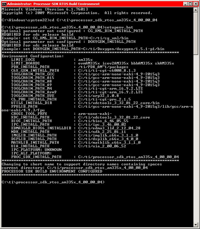

Environment Configuration:
    LIMIT_SOCS                : am335x
    LIMIT_BOARDS              : evmAM335x icev2AM335x bbbAM335x skAM335x
    PDK_INSTALL_PATH          : /ti/PDK_AM~1/packages
    C6X_GEN_INSTALL_PATH      : C:/ti/ti-cgt-c6000_8.1.3
    TOOLCHAIN_PATH_GCC        : C:/ti/gcc-arm-none-eabi-4_9-2015q3
    TOOLCHAIN_PATH_A15        : C:/ti/gcc-arm-none-eabi-4_9-2015q3
    TOOLCHAIN_PATH_A8         : C:/ti/gcc-arm-none-eabi-4_9-2015q3
    TOOLCHAIN_PATH_A9         : C:/ti/gcc-arm-none-eabi-4_9-2015q3
    TOOLCHAIN_PATH_M4         : C:/ti/ti-cgt-arm_16.9.2.LTS
    TOOLCHAIN_PATH_Arm9       : C:/ti/ti-cgt-arm_16.9.2.LTS
    TOOLCHAIN_PATH_EVE        : C:/ti/arp32_1.0.8
    CL_PRU_INSTALL_PATH       : C:/ti/ti-cgt-pru_2.1.5
    UTILS_INSTALL_DIR         : C:/ti/xdctools_3_32_01_22_core/bin
    FPULIB_PATH               : C:/ti/gcc-arm-none-eabi-4_9-2015q3/lib/gcc/arm-n
one-eabi/4.9.3/fpu
    CROSS_TOOL_PRFX           : arm-none-eabi-
    XDC_INSTALL_PATH          : C:/ti/xdctools_3_32_01_22_core
    BIOS_INSTALL_PATH         : C:/ti/bios_6_46_05_55
    IPC_INSTALL_PATH          : C:/ti/ipc_3_46_00_02
    EDMA3LLD_BIOS6_INSTALLDIR : C:/ti/edma3_lld_2_12_04_28
    NDK_INSTALL_PATH          : C:/ti/ndk_2_25_01_11
    IMGLIB_INSTALL_PATH       : C:/ti/imglib_c66x_3_1_1_0
    DSPLIB_INSTALL_PATH       : C:/ti/dsplib_c66x_3_4_0_0
    MATHLIB_INSTALL_PATH      : C:/ti/mathlib_c66x_3_1_1_0
    UIA_INSTALL_PATH          : C:/ti/uia_2_00_06_52
    IPC_PLATFORM: UNKNOWN
    IPC_ALT_PLATFORM:
    PROC_SDK_INSTALL_PATH     : C:/ti/processor_sdk_rtos_am335x_4_00_00_04
Changing to short name to support directory names containing spaces
current directory: C:/ti/processor_sdk_rtos_am335x_4_00_00_04
PROCESSOR SDK BUILD ENVIRONMENT CONFIGURED
(  Why is this set to my older XDC tools? )

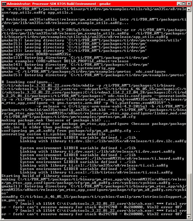

I do gmake clean followed by gmake.  It starts running, for about 5 minutes (which is way too much output to post).  Eventually it crashes during the build with the following:
# Invoking configuro...
C:/ti/xdctools_3_32_01_22_core/bin/mkdir -p /ti/PDK_AM~1/packages/ti/binary
C:/ti/xdctools_3_32_01_22_core/xs --xdcpath="C:/ti/bios_6_46_05_55/packages;C:/t
i/xdctools_3_32_01_22_core/packages;C:/ti/edma3_lld_2_12_04_28/packages;C:/ti/nd
k_2_25_01_11/packages;/ti/PDK_AM~1/packages;" xdc.tools.configuro --generationOn
ly -o /ti/PDK_AM~1/packages/ti/binary/pm_rtos_app/obj/evmAM335x/a8host/release/p
m_rtos_app_configuro -t gnu.targets.arm.A8F -p "ti.platforms.evmAM3359" \
               -r release -c C:/ti/gcc-arm-none-eabi-4_9-2015q3 -b /ti/PDK_AM~1/
packages/ti/build/am335x/config_am335x_a8.bld --ol /ti/PDK_AM~1/packages/ti/bina
ry/pm_rtos_app/obj/evmAM335x/a8host/release/pm_rtos_app_configuro/linker_mod.cmd
 /ti/PDK_AM~1/packages/ti/drv/pm/examples/pmrtos/pm_a8.cfg
making package.mak (because of package.bld) ...
generating interfaces for package pm_rtos_app_configuro (because package/package
.xdc.inc is older than package.xdc) ...
configuring pm_a8.xa8fg from package/cfg/pm_a8_pa8fg.cfg ...
generating custom ti.sysbios library makefile ...
        System environment LIBDIR variable defined : ./lib
        Linking with library ti.drv.i2c:./lib/am335x/a8/release/ti.drv.i2c.aa8fg
        Linking with library ti.drv.uart:./lib/a8/release/ti.drv.uart.aa8fg
        Linking with library ti.board:./lib/evmAM335x/a8/release/ti.board.aa8fg
        Linking with library ti.csl:./lib/am335x/a8/release/ti.csl.aa8fg
        Linking with library ti.osal:./lib/tirtos/a8/release/ti.osal.aa8fg
Starting build of library sources ...
making C:/ti/PDK_AM~1/packages/ti/binary/pm_rtos_app/obj/evmAM335x/a8host/releas
e/pm_rtos_app_configuro/package/cfg/pm_a8_pa8fg.src/sysbios/sysbios.aa8fg ...
gmake[1]: Entering directory `C:/ti/PDK_AM~1/packages/ti/binary/pm_rtos_app/obj/
evmAM335x/a8host/release/pm_rtos_app_configuro/package/cfg/pm_a8_pa8fg.src/sysbi
os'
asma8fg C:/ti/bios_6_46_05_55/packages/ti/sysbios/family/arm/IntrinsicsSupport_a
sm_gnu.asm ...
      4 [main] sh 13428 C:\ti\xdctools_3_32_01_22_core\bin\sh.exe: *** fatal err
or - fork: can't reserve memory for stack 0x29C780 - 0x2A0000, Win32 error 487
Can anyone point me to what is wrong?  This is 100,000's of lines into these packages that are supposed to work "right out of the box".  Is it because the build is happening with the old XDC 3.32?
When this error occurs, there are 10 child "gmake.exe" processing stalled, 8 child "sh.exe" processes stalled (and 1 xdc.exe, and 2 xs.exe).  Eventually, the cmd window starts spitting out messages like this
      6 [main] sh 11484 child_info::sync: wait failed, pid 13428, Win32 error 18
12
12
   3868 [main] sh 11484 fork: child -1 - died waiting for longjmp before initial
ization, retry 10, exit code 0x1000000, errno 11
C:/Users/scott/AppData/Local/Temp/make8604-1.sh: Cannot fork: Resource temporari
ly unavailable
gmake[1]: *** [arm_IntrinsicsSupport_asm_gnu.o] Error 2
gmake[1]: Leaving directory `C:/ti/PDK_AM~1/packages/ti/binary/pm_rtos_app/obj/e
vmAM335x/a8host/release/pm_rtos_app_configuro/package/cfg/pm_a8_pa8fg.src/sysbio
s'
gmake: *** [C:/ti/PDK_AM~1/packages/ti/binary/pm_rtos_app/obj/evmAM335x/a8host/r
elease/pm_rtos_app_configuro/package/cfg/pm_a8_pa8fg.src/sysbios/sysbios.aa8fg]
Error 2
Can anyone help?  Tell me what to do to get these packages working?

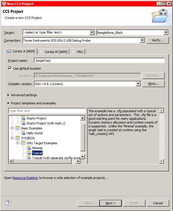

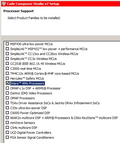

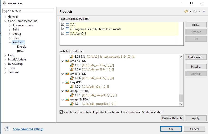

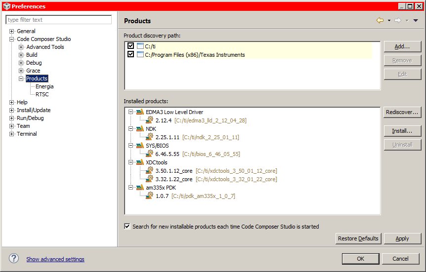

    Taking it from the top:  I install CCS 7.1 with only a few options:
       and
    Everything installs ok.  Then I install the packages, as shown in the screen shot in my previous reply.  When I start CCS7, it see the packages, and gives me warning about unverified material.

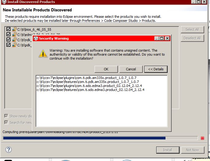

    I install it anyway.  Then  New project:
    And the RTSC tools:
    I press OK, and build. I edit NO CODE.  I get 30 errors.

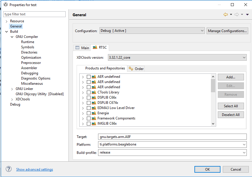

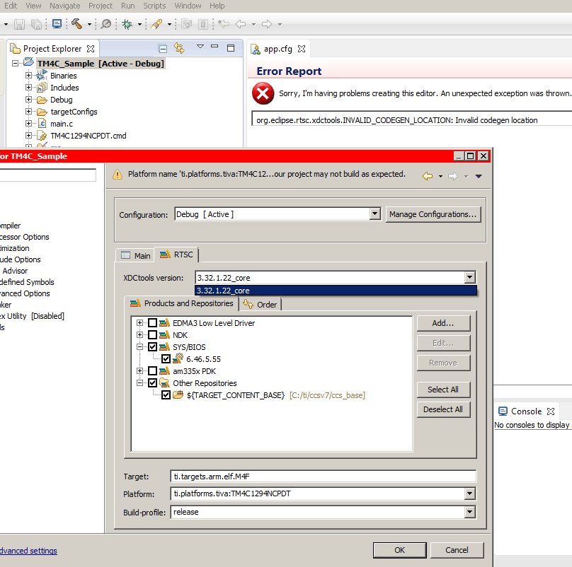

    I change the XDC to the old version
    And try again.  Now it builds, but crashes when opening up the config file.
    So, either way, I can't use it.
    So I went into the C:\ti\processor_sdk_rtos_am335x_4_00_00_04 folder to rebuild the RTOS.  Here is the environment setup...
    I run gmake clean, then gmake, and after a few minutes of building some things, I get these crashes:
    This should be everything you need to reproduce the problem.

  • CSW,
    You are dealing with 2 different issue here.
    * Downgrading from XDCtools version from 3.50 to XDCtools 3.22
    * PM LLD example build issue seems to be a Windows Host issue where the cygwin utility is running out of stack when you invoke build on the entire package.
    The first issue with XDCtools 3.50 is known. when you create a project using XDCtools 3.50, then downgrading to XDCtools 3.22 will mess up the RTSC setup. My recommendation is to delete the XDCtools 3.50 that comes with CCSv7.1 unless you are using TI MCU products that require that version. Processor SDK RTOS has not updated to that version due to incompatibility with IPC and related components.
    If you don`t want to delete XDCtools 3.50 then the other option is to pay attention to the version when creating a TI RTOS Typical project in CCS. In the screenshot where you are picking the XDCtools version, you can pick XDCtools 3.22 from the drop down option. In the screenshot you provided your initial project generation is being done with XDCtools 3.50 and this is causing an issuing your first issue.
    I have seen the second issue on my older Windows machine when I invoked the build on the entire SDK package but didn`t see this issue when I locally build just individual components in the SDK. for example instead of gmake clean and gmake all , I invoke the build for individual components.
    For EG : to build board and bootloader, you can invoke:
    gmake board_clean
    gmake board_lib
    Similarly of PM LLD use
    gmake pm_clean
    gmake pm
    I was not able to root cause the stack error issue but it appears similar issue can be seen with other software as well as you can see from herE:

    However, I have removed the XDC 3.50, and I also tried creating the project just plain with XDC 3.32. In both cases, the error occurs. It is as though CCS 7.1 is completely incapable of processing a cfg file with XDC 3.50.
    Is there anyway to prevent CCS 7.1 from even installing it?

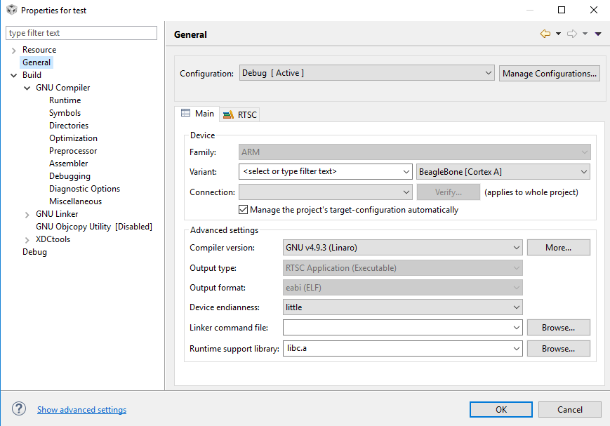

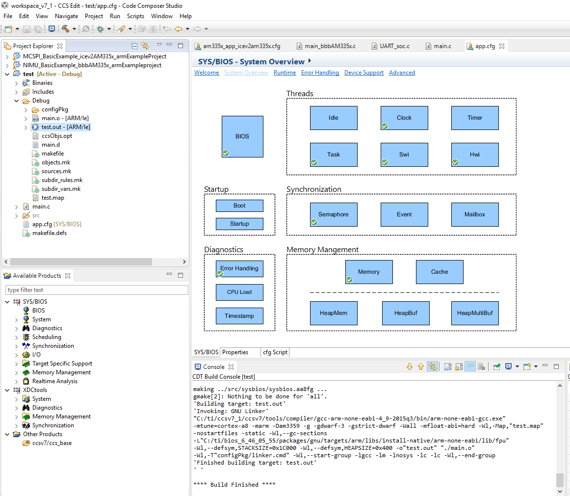

    I installed every known update to Windows 7.  I removed every piece of CCS 6.2 and 7.1 I could find.
    Then I installed CCS 7.1, and immediately removed XDC 3.50 directory.  Natually, it prompted me, telling me something was removed.
    Then I installed ti-processor-sdk-rtos-am335x-evm-04.00.00.04-Windows-x86-Install.  When I restarted, I had to delete the previous "workspace_7.2" folder, so it created a new one. Then it installed all the new packages.  I then created a new project and built it.
    However, under no conditions can I get CCS 7.1 to open the CFG file.  You can see below there is the error, and only XDC 3.32.

    I tried creating a "typical example" with the environment settings you mentioned above and was able to do so without issues. It also built fine without problems opening the .cfg file in XGCONF.
    Here are some screenshots of my setup in CCS v7.1 using XDC tools 3.32.1.22

    - Do you have the PDK and CCS installed at the default installation location C:ti\ ? If they were installed at another directory location, then the scripts would need to be adjusted as mentioned here http://processors.wiki.ti.com/index.php/Processor_SDK_RTOS_Install_In_Custom_Path
    - On a Windows command prompt you navigated to C:\ti\pdk_am335x_1_0_7\packages\ and ran the command pdksetupenv.bat followed by pdkProjectCreate.bat AM335x all little all arm. Correct?

    - Do you have all the Processor SDK RTOS components registered in CCS as seen below?
    Lali

    I am following these steps:
    processors.wiki.ti.com/.../Rebuilding_The_PDK
    The folder with that batch file I ran is in "processor_sdk_rtos_am335x_4_00_00_04" . NOT the  "pdk_am335x_1_0_7"  I run pdksetupenv.bat  then gmake, and it fails after a while.
    I have run the batch file in C:\ti\pdk_am335x_1_0_7\packages and it builds to completion.
    But it does NOT complete when I call the build batch file in C:\ti\processor_sdk_rtos_am335x_4_00_00_04
    What is the difference between these folders?   I have no information on them.

    - What is the fork error you see?
    As my post indicates,   I have this error:
    sm_gnu.asm ...
    Here is my "installed products" screen. From your image, I do not have any of "omapl" products, and don't know if I need them, nor do I need the am437x.  If there are other things needed I don't know what they are.
