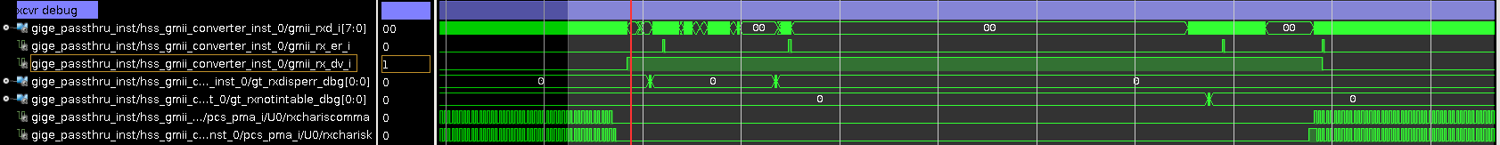

  • View of the entire BOOTP req packet.  There are 4 cycles where rx_er is asserted, but the last one is simply calling for carrier extension (occurs after rx_dv goes to 0). See figure 1.

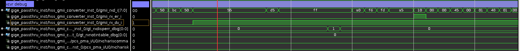

    Zooming in on first error in the ethernet header, where source MAC addr is bad (should be a0:f6:fd:a5:e5:10).  We always see consecutive 0xA5’s when there is an error here. See figure 2.

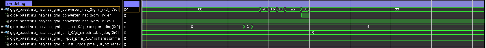

    Zooming in on second error in the payload where source MAC addr is also bad.  Sometimes this second instance of the MAC addr is correct, even when the first instance is bad. See figure 3.
    Zooming in on the third error near the end of the payload.  This bad piece of data is always 0xC4 and is flagged as not in table.  See figure 4.

    In these diagrams the GMII signals (gmii_rxd_i, gmii_rx_er_i, gmii_rx_dv_i) are delayed by a few clock cycles with respect to the transceiver status debug signals (gt_rxdisperr_dbg, gt_rxnotintable_dbg, rxchariscomma, rxcharisk).  This is because we are tapping them off in chipscope at different levels of the logic.  However, gmii_rx_er_i, gmii_rxd_i, and gmii_rx_dv_i are being displayed in synchronized time.
    In the 2nd and 3rd diagrams, we are claiming that the second occurrence of 0xA5 is incorrect because the sequence of data in that part of the packet is clearly supposed to be the Keystone2’s MAC address.  The gmii_rx_er_i signal is asserted because there is a 8b/10b disparity error, which can be seen flagged a few clock cycles earlier.  That doesn’t mean that the data associated with it (0x10) is necessarily bad though.  It only means that the transceiver was expecting a positive or negative disparity encoding and received the opposite.  The previous byte could still be at fault.  0xA5 has neutral parity and the same symbol for both its positive and negative encoding, which means it cannot cause the disparity error. Here is what might be happening:
    8B    10B-        10B+              Net parity
    0xA5  1010011010  same as neg       neutral
    0x10  0110110100  1001001011        neutral
    0xE5  1010011110  1010010001        +/- 2
    Before the two 0xA5s, we received 0xFD are at a +1 disparity count (same idea applies if starting at -1).  The expected sequence of a packet with the correct MAC address would be:
    0xA5 -> 0xE5 -> 0x10
    0      -2      +0      (symbol’s disparity)
    +1      -1      -1      (running disparity count)
    If we receive a rogue 0xA5 in the middle but the 0x10 is still encoded with its positive symbol as if a 0xE5 was sent, then the transceiver could be expecting the negative symbol for 0x10 even though it has neutral parity:
    0xA5 -> 0xA5 -> 0x10
    0       0      +0
    +1      +1      +1

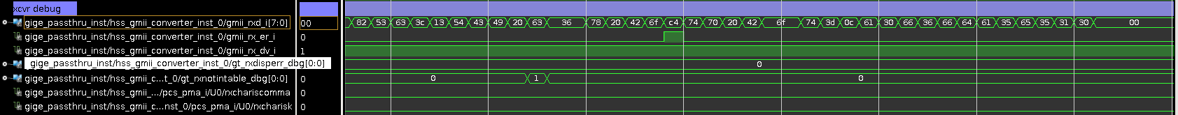

    The 4th diagram is unrelated to the previous 2.  It is a repeatable error that I have no theories on.

  • In the 4th data capture screenshot posted above, the sequence of data in the payload is ascii code for the following string: "TCI c66x Bootp Boot= a0f6fda5e510".
    The 0xC4 byte should be 0x6F (second 'o' in "Boot"). I have no theories on this failure yet.
