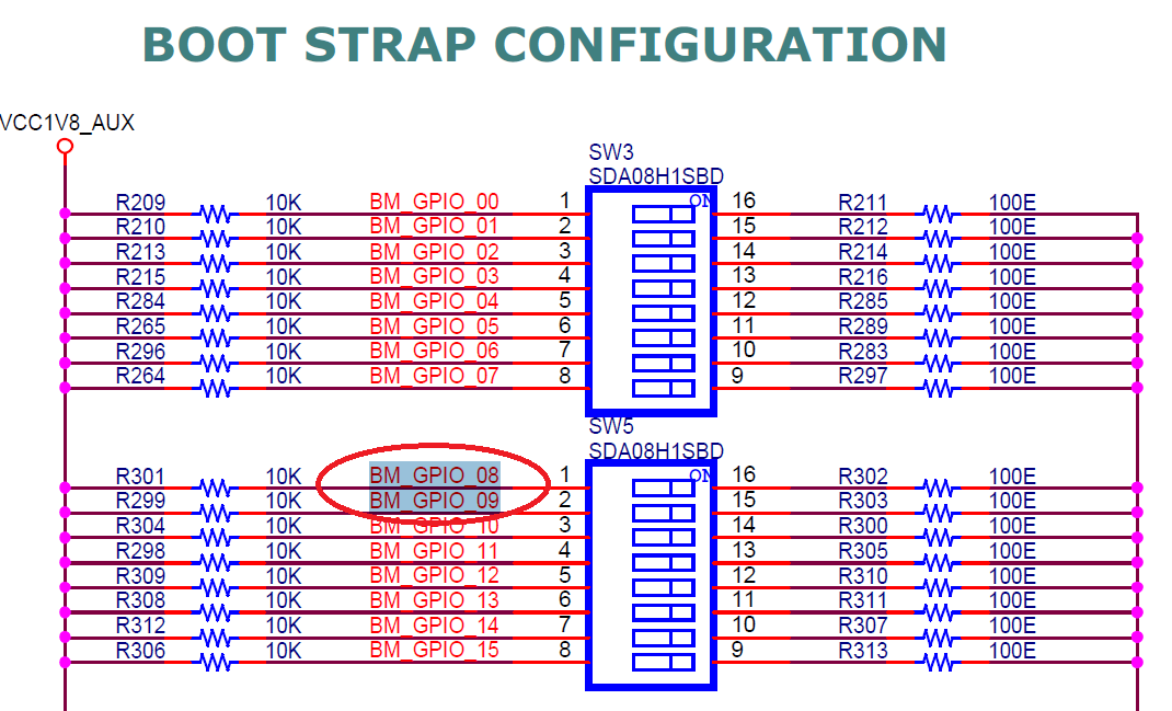

Hello champs,
I am a liitle confused with the chip select field value for C6657 bootmode pin 7,8 in SPI boot mode.
In below thread, the chip select field value 00:   CS0 and CS1 are both active - do not used
https://e2e.ti.com/support/dsp/c6000_multi-core_dsps/f/639/t/283454

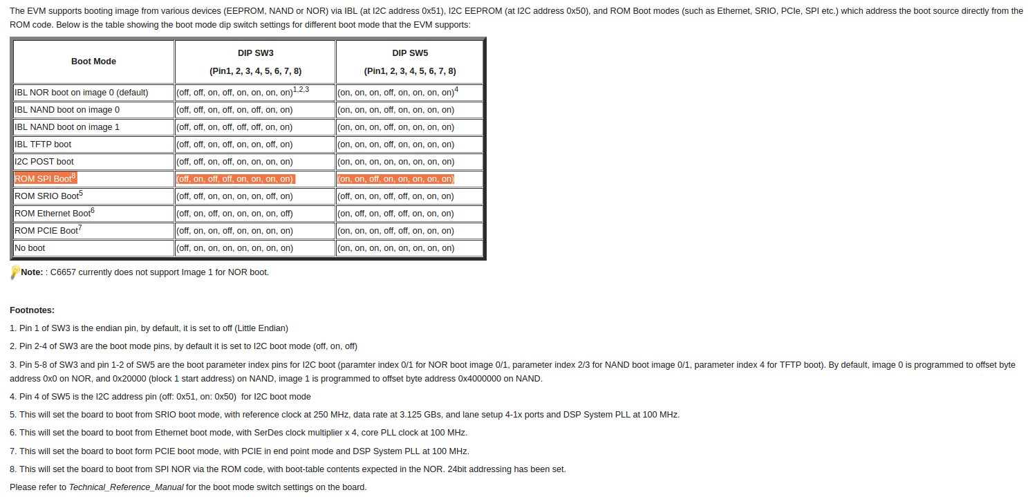

While in below wiki website, the bootmode pin 7,8 is 00 for ROM SPI Boot
http://processors.wiki.ti.com/index.php/TMDSEVM6657L_EVM_Hardware_Setup#Boot_Mode_Dip_Switch_Settings
Which one is correct?
