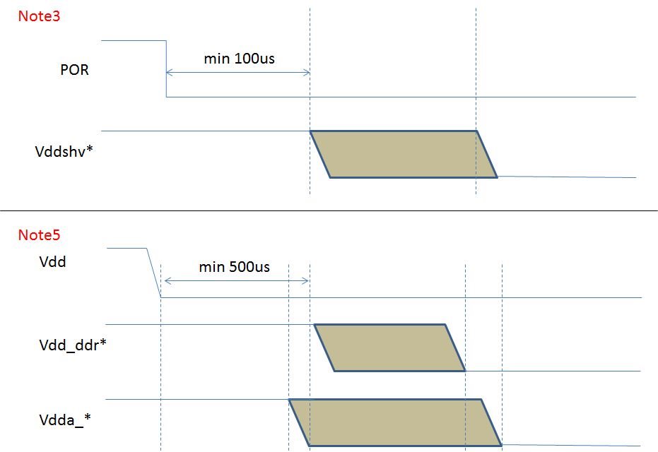

    1) I attached the figure to avoid my misunderstanding. Could you check whether it is OK?
    As same as note5, 500us is minimum time isn’t it?
    I believe that using PMIC is the best way. However, I need to know the specification of TDA3 exactly as a power designer for automotive application.

  • Hi Kenshow,
    Not sure what is your question, but above diagrams look valid... with one note - vdds_ddr* must be ramped down before vdds18v.
    I do not see timing for vdds18v, but assume it starts ramping down after vdds_ddr*.
    In general, there are no dependencies between vdds_ddr* and vdda_* domains.
    Dian

  • Hi Dian,
    My question is about NOT 3 and 5 of Figure 5-2. Power-Down Sequencing in DM.
    Note 3 is written "they can start ramping down no sooner than 100μs after PORz low assertion".
    Note 5 is written "vdds_ddr* can start ramping down no sooner than 500μs after vdd".
    So, I want to reconfirm about the idea of the defined time, 100us and 500us.
    Is my figure OK?
    Kenshow
  • Please find below further clarifications regarding Notes 3 & 5 of the TDA3x Power Down Seq diagrams.
    Note 3:
    PORz must be asserted low for 100us minimum elapsed time before any TDA3 voltages go below their minimal functional level to ensure all SoC circuitry has been set to a known safe state. If any vddshv* uses 3.3V, then this supply must remain greater than 2.7V for 100us after PORz is asserted low. If all vddshv* are set to 1.8V & using same supply source as VDDS1V8, then they can ramp down at the same time as VDDS1V8.  In this case, the 1st supplies to ramp down will be vdd & vdd_dspeve.  Niether of these supplies should begin ramping down no sooner than 100us after PORz has been asserted low to ensure TDA3 has been set to a safe state before SoC voltages begin the power down seq.
    Note 5:
    The 500us delay before disabling vdds_ddr is intended to allow vdd to begin discharging with sufficient time so that vdds_ddr supply does not ramp down more quickly than vdd.
