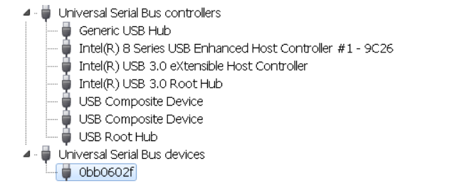

  • I am posting some of my notes based on our testing of this feature in the ROM bootloader:
    • Connect to USB1 port and set the boot switches to USB boot, setup boot switches to USB boot:
    When you power on, you should see the USB device enumerate on the host:
    Host setup:
    •    Download Zadig utility to install WinUSB? driver. download link:
    •    Download DFU writer utility version 0.7 from here :
    •    Run DFU utility with the boot image using the command                                                                                                                                                             dfu-util.exe -D <bootimage>_gphdr.bin
