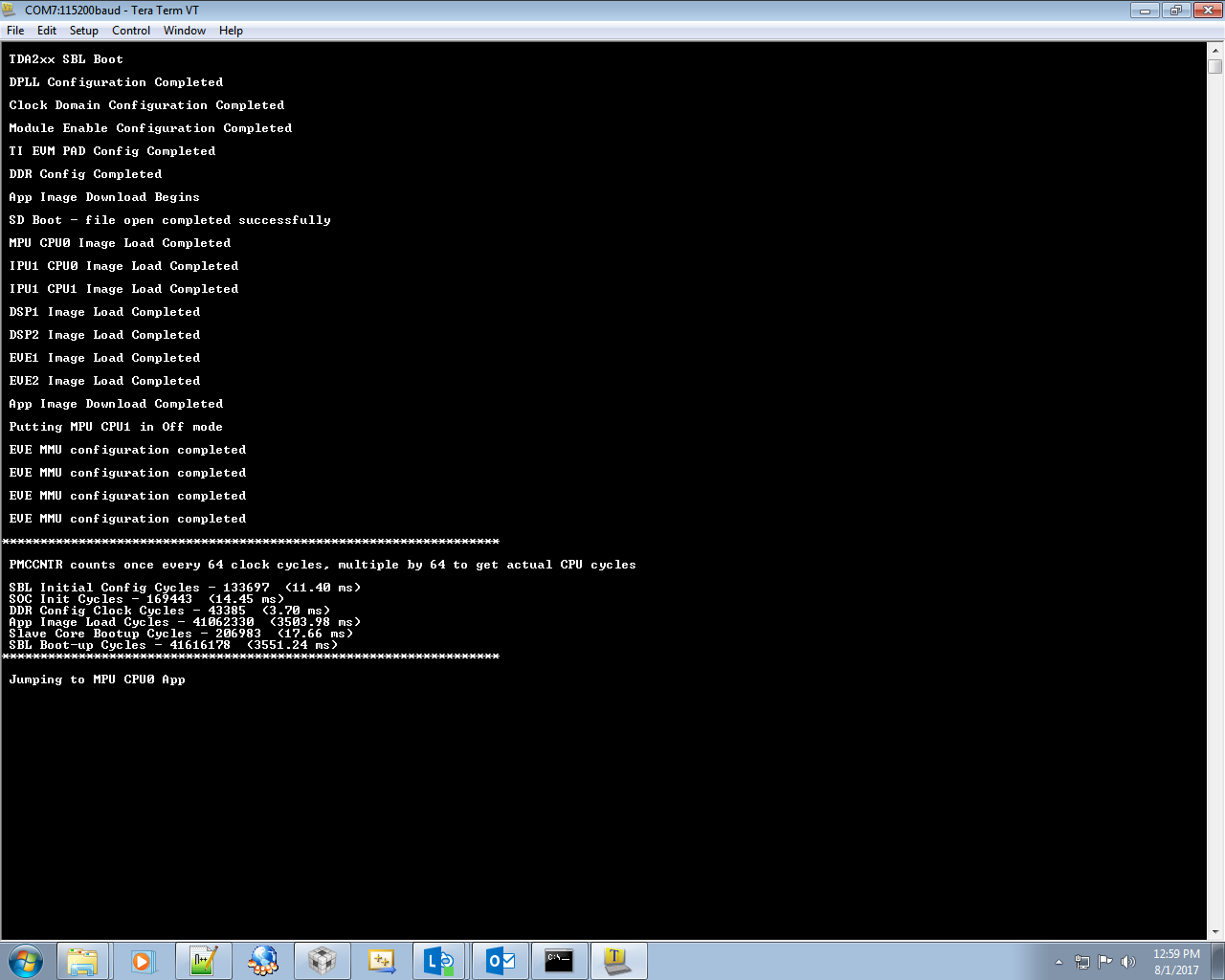

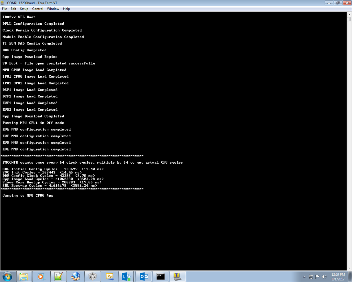

  • Hi Rishabh,
    As per your recommendations, mapped 0xA000_0000 logical to 0xA000_0000 physical address. However it is not booting and prints  “Jumping to MPU CPU0 App”.
    When i revert back the changes then it is booting up properly. Please find attached screenshot with this chain.
    Socrates

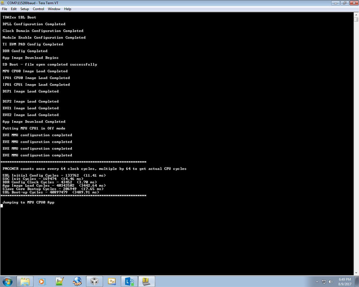

  • Hi Rishabh,
    Changes were made as per your suggestion. However MDMA error is not resolved yet.
    Please find attached error logs.
    Are the below changes correct? Please advise.
