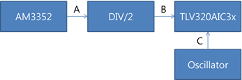

Actually, my customer's system configuration was as below, and A is CLKOUT1 24Mhz, and 'DIV/2' is external device to divide CLKOUT clock.(24Mhz -> 12Mhz)
As we recommended CLKOUT1 should not be used for external device clock, they removed 'DIV/2' device and disabled CLKOUT1, but found the junction temperature of AM3352 was increased by 5C(79C -> 84C).
They want to know if this is reasonable situation or not.
