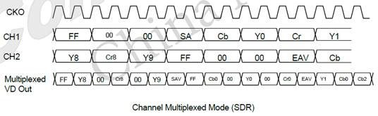

Hi all,
Does J6Entry support BT656 in SDR mode on video input port?
Thanks in advance.
B.R.
OC

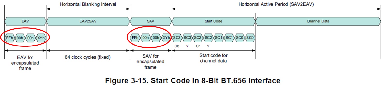

Hi OC,
VIP does support multiplexed input mode, but in this mode, the sync word is replicated as explained in the section 9.4.5.8 of the TRM. So in order to capture this stream, you should also have multiplxed sync word.
Rgds,
Brijesh
