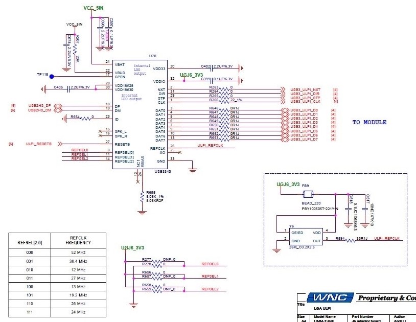

Hi expert,
1. I use GLSDK 3.02.00.03, sometimes error occur when dwc3 register ULPI interface.
2. I use Microchip USB3340 as ULPI PHY and its reference clock set to 26 MHz (OUTPUT Mode, REFSEL[2:0] 110), it can let ULPI PHY to generate 60 MHz clock to CPU module.
3. Error message shows:
      [    5.597565] dwc3 48910000.usb: failed to register ULPI interface
4. I found the function ulpi_write(ulpi, ULPI_SCRATCH, 0xaa) in ulpi_register() error, that is, return value is -110 by dwc3_ulpi_busyloop(dwc) in dwc3_ulpi_write(), count=1000 and decrease to 0 and then timeout value ETIMEDOUT returned.
Could you please help to provide debug procedure.
Thank you.
BRs
Louis

  • Hi Louis,
    Can you post or send us the schematic diagram between SoC and PHY?
    As far as I know ULPI was not tested after silicon release and ULPI pins remained only for backup. I think not much people have experience with ULPI.
    Stan
  • Hi Stan,
    The attached file is our schematic.
    BRs
    Louis

    Regarding the schematic, I've scrolled through microchip spec and through our TRM. I have the below questions/remarks.
    - You are in host mode, correct? (ID=0)
    - Looks like you need the 'VBUS power switch' to be present even in always-host mode and controlled by CPEN pin. I don't see it on your diagram
    - In host mode, you need Cvbus with at least 120 uF capacitance, see TABLE 8-2 in mchp spec
    - It's doubtful to me why is the 22-ohms for the ulpi clk? DAT pins can be as fast as CLK, but they are 0 ohms
    - (not critical) Rvbus you set it at the highest possible value (20k). It should be good , but I would select something in the middle 1-20k during tests
    Additionally, consider contacting microchip as most of the schematic you posted is related to the phy chip.
    And at last, as I already mentioned, ULPI interface doesn't have official TI support. It is there and has pins pinned out but it was not tested up to my knowledge. The device TRM is even more restrictive, it says 'do not use ulpi'...
    Stan

    Louis,
    One more to pay attention for : Check to which DRA75x balls the PHY is connected. And if these balls are powered 1.8V or 3.3V. See if PHY is at same voltage or tolerates the SoC-side voltage.
    Also please consider my comments in my previous post,.
    Stan
  • Hi Stan,
    1. Our hardware engineer response as below,
    --> No concern, it connects to GND.
    --> No concern. It is a float pin.
    --> No concern. Power has other decoupling Caps.
    --> Checking the document.
    --> No concern. 20K Ohms follows datasheet requirement.
    BRs
    Louis
  • Hi Louis,
    The diagram doesn't show the connections down to the USB connector, therefore I don't have enough visibility...
    Can you post the diagram with the USB connector and signals? You can email me it f you wish.
    Stan
