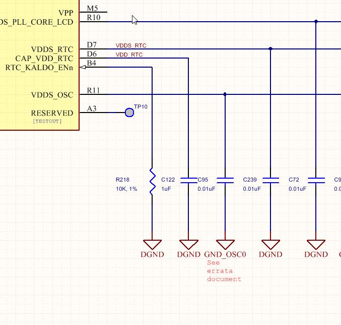

in the design starter kit is
see errata document.

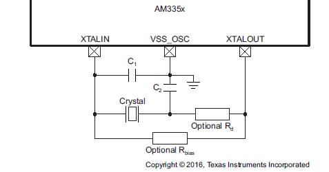

In the datasheet is it as follows:
is the GND connection of the crystal right ?
like shown in the DS it doesn't make sense... Does C239 really connect to GND .
How is the right connection ?
