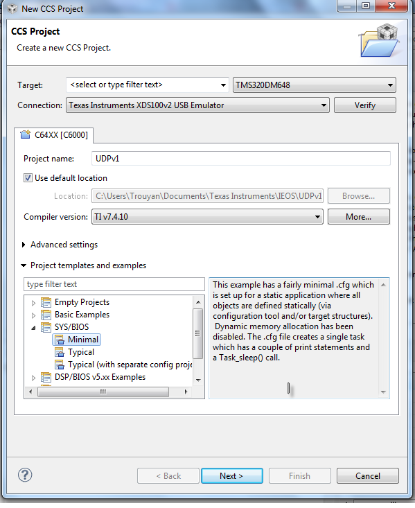

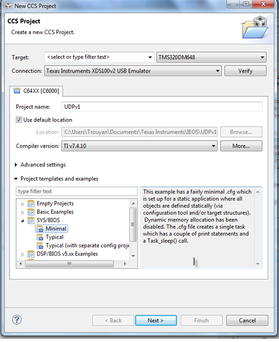

    1. Create CCS Project

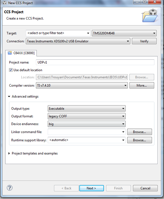

    - set Big endian
    -chose SYS/BIOS minimal configuration

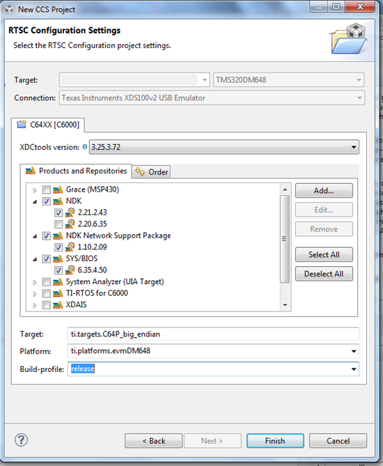

    - Select NDK, NSP and set platform

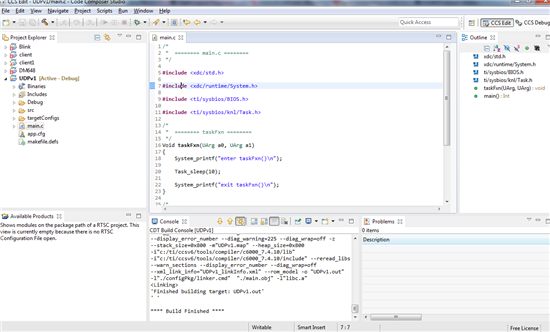

    - Then I build project. And success it:

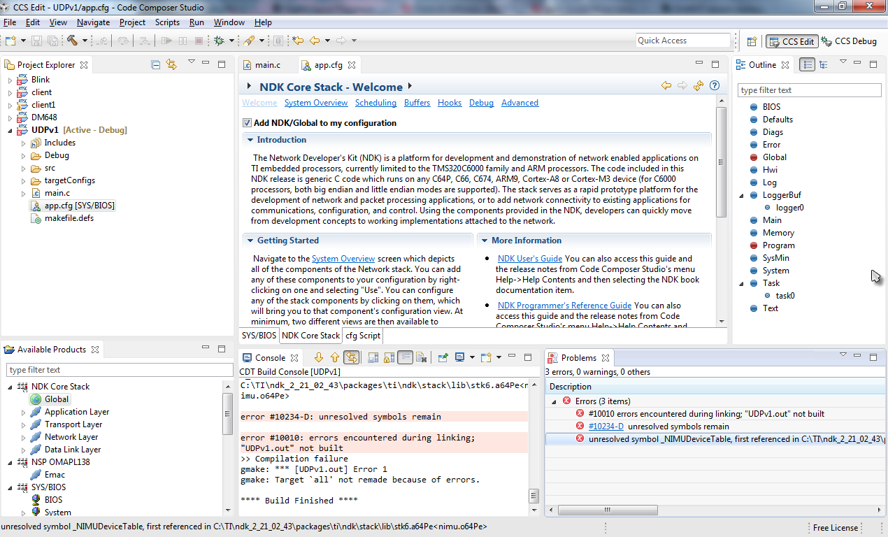

    - Finally I added NDK into app.cfg. Then tried to build and got some errors:
    Where I made mistake ? Help please.
