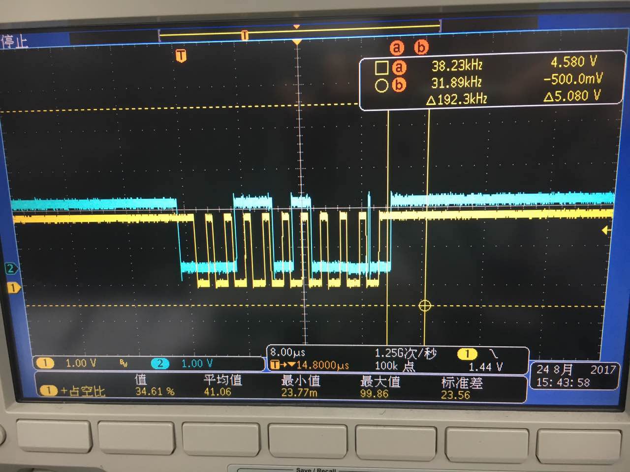

DRA750: I2C4 timeout with FPD-Link949 on J6 ( 6AM1.3 SDK )
Part Number: DRA750
Other Parts Discussed in Thread: DS90UB949-Q1, DS90UB948-Q1, TLC59108, DRA742, DRA752
Hi ,
we use ds90ub949-q1 &  ds90ub948-q1 for the HDMI display in my  project  and ds90ub949-q1 is connected to the I2C4 .
When init the ds90ub949  ,the error log shows "fpd3_serdes 3-001a: Failed to read 0x00, Error = -121 xxxxxx " .
From the wave form ,we can see that ds90ub949 has given back ACK when J6 sends the salve addr (0x1A) .
Here is the DTS config :
&i2c4 {
        status = "okay";
        clock-frequency = <3400000>;
        disp_ser: serializer@1A {
                compatible = "ti,ds90uh949q";
                reg = <0x1A>;
                pinctrl-names= "default";
                pinctrl-0=<&i2c4_pins>;
                #address-cells = <1>;
                #size-cells = <0>;
                ranges = <0x2c 0x2c>,
                        <0x1c 0x1c>;
                disp_des: deserializer@2c {
                        compatible = "ti,ds90uh948q";
                        reg = <0x2c>;
                        slave-mode;
&disp_ser {
        fpd_disp: tlc59108@1c {
                #size-cells = <0>;
                compatible = "ti,tlc59108";
                reg = <0x1c>;
i2c4_pins: i2c4_pins{
                pinctrl-single,pins=<
                        0x2AC (MUX_MODE10) /* i2c4_SDA */
                        0x2B0 (MUX_MODE10) /* i2c4_SCL */
The Log is as follow :

[    4.413124] omap_i2c 4807a000.i2c: addr: 0x001a, len: 1, flags: 0x0, stop: 0 ,speed: 400
[    4.413198] fpd3_serdes 3-001a: Failed to read 0x00, Error = -121 xxxxxx
[    4.413205] [baker] read ret=-121
[    4.416216] fpd3_serdes 3-001a: Not a fpd3_24b_ser chip
[    4.416228] fpd3_serdes 7-002c: Failed to write 0x02 to 0x01
[    4.416245] fpd3_serdes: probe of 7-002c failed with error -5
[    4.416408] fpd3_serdes 3-001a: Serializer fpd3_24b_ser ready
[    4.416473] omap_i2c 4807a000.i2c: addr: 0x002c, len: 2, flags: 0x0, stop: 1 ,speed: 400
[    4.416549] fpd3_serdes 7-002c: Failed to write 0x02 to 0x01
[    4.416566] fpd3_serdes: probe of 7-002c failed with error -121
