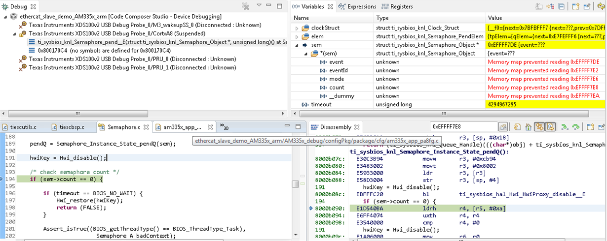

I am getting an exception at the call of UART_printf("\nVersion - "); in task1(). When I did step by step debugging then I found that it is throwing exception at semaphore_pend in Semaphore.c file. The sem variable is not getting initialized and sem->count is throwing exception. What could be causing this un-initialized semaphore. I am using the gel file of CCS7.1.0 so it if 2.1 version.
I tried this same sample application on different machine and I see exception issue with semaphore access only. Earlier I had seen this issue at the call SPI_open() where exception was thrown at semaphore access.
Can some one please help me on whether I need to do some changes in build environment which I am missing? I can run the pre-built binary on my setup without any issue.

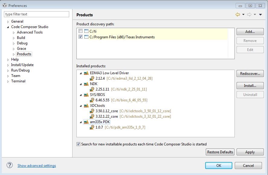

    If you have installed the Processor SDK, Pru-ICSS_Protocol, or CCS in a directory other than C:\ti then we need to make sure that CCS knows where all of the related files are location. This is done by going to CCS -> Window -> Preferences -> Products and then entering the Install Directory path for CCS, Processor SDK and the EProtocol (EtherCAT) . Remove any directories which are not part of this configuration. You will also need to edit the EtherCAT - project create script in [INSTALL-DIR]/PRU-ICSS-EtherCAT_Slave_01.00.04.02/projects/projectCreate.bat to point to the correct locations of CCS, Processor SDK and EtherCAT.

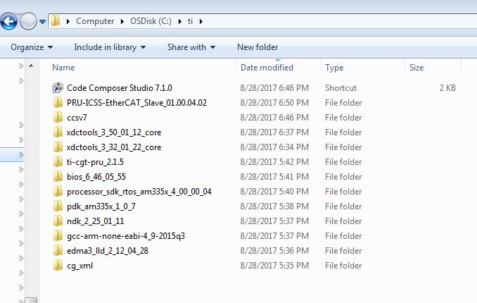

    At this point C:\ti should look like
    10) Restart CCS and permit it to go through it's initialization so that it recognized the files that are downloaded with PRU-ICSS EtherCAT.
