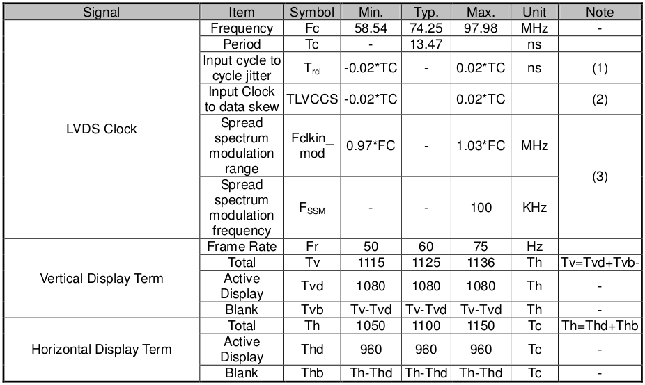

I am currently trying to enable the driver for DSI to LVDS, I am trying to initiate the test pattern based from this specs
but for some reason, it always displays black, hoping someone can help me with the correct register setting for this specs

  • Hi Yordan,
    thanks for the reply, to answer the question, I am running on android platform but for now,
    I think the hardware can be abstract since I am aiming to run the Test Pattern for now
    I am developing custom driver for SN65DSI84 and for some reason, the test pattern only shows black display.
    i2c communication is already established
    DSI clock input is already established running at 420Mhz
    LVDS output is now configured to divide by 7 which gives me 70Mhz, required by my LCD
    so here is the summary. of my driver
    software reset
    PLL disabled
    LCD settings for Horizontal and vertical
    Sync
    Porch front and back
    Test Pattern = 0x16 (enabled)
    PLL enabled
    software reset
    Still no display for test pattern, so my conclusion is that it may have something to do with
    LCD horizontal/vertical settings
    Sync
    Hope you can help me, thanks
