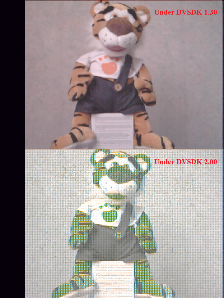

Hello everybody.
Does anybody work with LI-3M01 under DM6446 EVM DVSDK 2.00 ?
Leopard Img. examples are working fine under DVSDK 1.30, but they do not work under DVSDK 2.00 (it writes: DoPreview: Cannot convert)
Does anybody was faced with such problem?
Please help...

  • I have been patched kernel with four patches according to LI-3M01 User Guide, recompiled kernel and examples. Under DVSDK 1.30 everything is working fine, I am receiving good frames (attached file 'tiger.bmp'). Under DVSDK 2.00 examples don't work, the output is:

    But, if Capture device is initializated without O_NONBLOCK flag then camera starts work and I recieve frames. But frames are bad (attached file 'tiger.bmp'). Frames have wrong colors. I suppose that previewer initializated wrong although examples are original.
    So, I can't start properly LI-3M01 examples under DVSDK 2.00. Did anybody do this?
