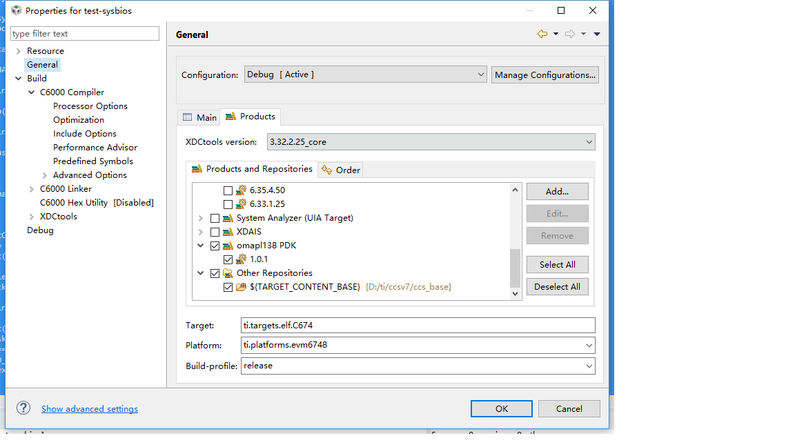

RTOS/TMS320C6746: undefined symol: Board_init. Where is Board_init? Am i miss something?
Part Number: TMS320C6746
Other Parts Discussed in Thread: OMAPL138
Tool/software: TI-RTOS
here is my code:

This is project property:
  • Board_Init API comes from the board library which is part of PDK. If you are runnning this on LCDK platform then, you need to add the following in your .cfg file.
    var devType = "omapl138"
    /* Load the OSAL package */
    var osType = "tirtos"
    var Osal = xdc.useModule('ti.osal.Settings');
    Osal.osType = osType;
    Osal.socType = devType;
    /*use CSL package*/
    var Csl = xdc.loadPackage('ti.csl');
    Csl.Settings.deviceType = devType;
    /* Load the Board package and set the board name */
    var Board = xdc.loadPackage('ti.board');
    Board.Settings.boardName = "lcdkOMAPL138";
    <Add any drivers as required.>
    Please note, before creating your examples refer to some of the PDK examples to understand how this works. to Create PDK driver examples, you need to run the pdkProjectCreate script as shown here:
    Make sure that your PDK or Processor SDK RTOS build environment is setup before you run the Project create script.
    Rahul

    Problem solved
    i found your uart sample app.cfg.
