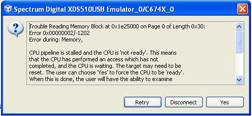

Hi all,
I have a customer that is having problems to connect to CCS in his custom board (but not in the EVM), he is getting this error (clicking "yes" did not solve it):
We analyzed the problem and it does not seem to be a CCS issue as he did not make any updates and the same software and same GEL file work fine in the EVM.
When the problem started occurring, no hardware changes were made. The problem occurred the first time he tried to access the USB1 peripheral module. No initialization changes were made. Error occurs even before any software is sent to the board. No upgrades in CCS have been made in a while.
Both devices are: XOMAPL137ZKB3 or:Experimental OmapL137 SiliconRev1.0 0-90*C 256BGA 300MHZ
I asked to make sure that the board was in EMU boot and he did, but no change.
Could it be related to some USB state? Is there more information on SPRZ291D: Advisory 1.1.9 (Slew rate on USB0 and USB1 power supplies)?

  • I am the customer that Mariana is speaking of, and:
    1. The USB0 is accessible through CCSv4 while USB1 is not. With the exact same GEL File (and like wise PSC settings) I can access both on the EVM.
    2. The pins F3 and H4 had no effect on this problem. (we were able to connect and disconnect these on the custom board)

  • I quickly tried to comment out the line that highlighted in the GEL file and try to access the USB1 memory map on the SD OMAPL137 EVM and I get exactly the same emulation error as was posted in the first post. So it does look like a clock source issue.

  • 1) Power is applied to the pins
    2) PSC1.MDSTAT1.State = 3 PSC1.MDSTAT2.State = 3
    3)Sys_Cfg_Regs.CFGChip2.all must be set to a minimum of 0x8C2 (0x9F2 also works).
    To prevent processor lockups:
    Sys_Cfg_Regs.CFGChip2.USB0Ref_Freq must be set (read only bit) before reading from USB_1.
    Mukul your CFGChip2 was the key.
  • One mistake in the last post:
    Sys_Cfg_Regs.CFGChip2.USB0PHYCLKGD must be set (read only bit) before reading from USB_1.
