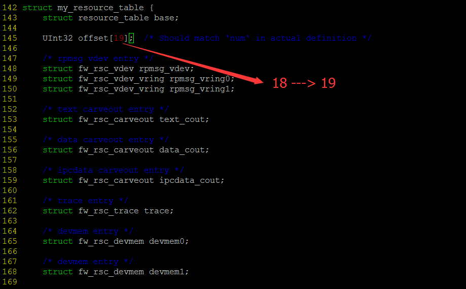

TI,I am working for share memory between ARM and IPU1,but the ipu call Resource_physToVirt() function is failed! It say that the ipu can not get the physical address 0xa0000000.
Here the log:

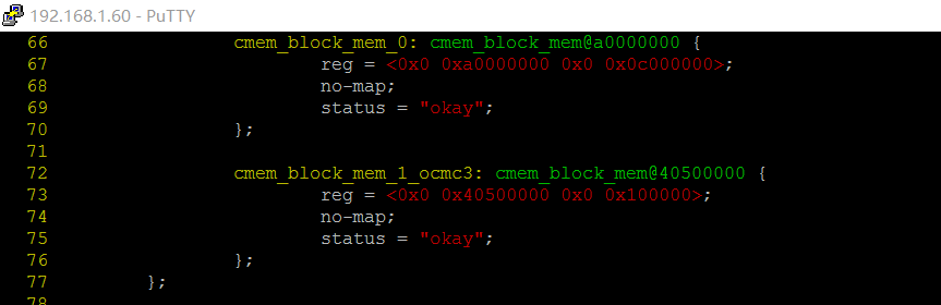

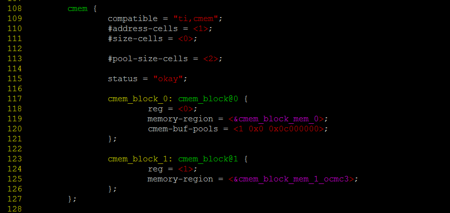

use the same code,the ARM and DSP1/DSP2 are work find.
I had add the cmem configuration at rsc_table_ipu.h and config.bld.
I double the IPU memory configuartion is not right.Could you help work on it?

    If I understand correctly you want to run these rtos binaries under linux, right?
    Can you share the am57xx-evm-cmem.dtsi content?
    Yordan
    Yordan,
    The cmem configuration like that:
    BR,
    vefone

    So the ipuAmmu.cfg file configures the following:
    /* config large page[3] to map 512MB VA 0xA0000000 to L3 0xA0000000 */
    This is part of the ddr and it complies with the definitions in am57xx-evm-cmem.dtsi file:
    cmem_block_mem_0: cmem_block_mem@a0000000 {
    reg = <0x0 0xa0000000 0x0 0x0c000000>;
    no-map;
    status = "okay";
    and with am57xx-beagle-x15-common.dtsi:
    &ipu1 {
    status = "okay";
    memory-region = <&ipu1_cma_pool>;
    mboxes = <&mailbox5 &mbox_ipu1_ipc3x>;
    timers = <&timer11>;
    watchdog-timers = <&timer7>, <&timer8>;
    ipu1_cma_pool: ipu1_cma@9d000000 {
    compatible = "shared-dma-pool";
    reg = <0x0 0x9d000000 0x0 0x2000000>;
    reusable;
    status = "okay";
    How are you accessing the ram at address 0x80000000? Maybe you need some translation first.
