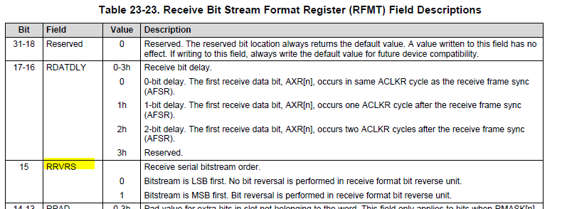

Does anyone know how the samples are encoded between the codec and the DSP?
In the mcasp example, the samples are stored in a signed char array. However, this does not give an indication about how the original data was encoded, i.e., short, int, float?
thank you,
