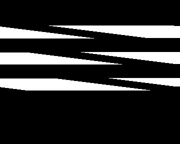

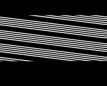

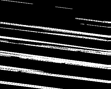

In the fucntions related to the connected components labeling, namely:
VLIB_createConnectedComponentsList
VLIB_createCCMap8Bit
I am feeding the VLIB_createConnectedComponentsList with the packed foreground mask extracted from one of the VLIB Background Subtraction algorithms.
When i see the output of VLIB_createCCMap8Bit and threshold it so that all components are in white (Using IMGLIB) the result is not has expected.
In fact an object will be drawn has several diagonal lines. This led me to think that the frame_width and frame height parameters of VLIB_createConnectedComponentsList were wrong. I double checked them and they are correct. Just as a trial i inverted them, this is, i  wrote the height in the width and vice-versa, and the results were more close to the real. still a black region would float around in the output image (what is acceptable has the values were wrong).
is this something to do with the layout in memory of my input image?
I have it in memory like : LINE1 | LINE2 | LINE3 ... is the VLIB expecting COL1|COL2|COL3
I also read somewhere that the bit packed data "are different" for VLIB and IMGLIB, in the sense that the first requires bit reversed data. (Is this of any interest for my problem?)
Any help would be appreciated.
Best Regards

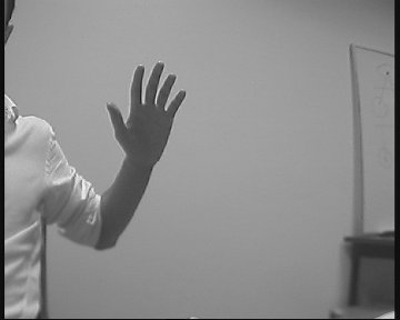

    Important: I also downgrade the resolution by extracting only 1 out of every two lumas.
    encBufSize=720*576/4
    encBuf      = (unsigned char * )Memory_contigAlloc( encBufSize, 8 );
    decBuf      = (unsigned char * )Memory_contigAlloc( encBufSize, 8 );
    decBuf2     = (unsigned char * )Memory_contigAlloc( encBufSize, 8 );
    I capture images with the DMAI Capture Functions
    //p_src_img->Capture Image UYUY format (720*576)
    //p_dst_img->Output Luma Image (360*288)
    //src_w -> 720
    //src_h->576
    //bpp->2       (2 bytes per pixel)
    char ExtractReduce_Y( unsigned char*  p_src_img,unsigned char*  p_dst_img, int src_w, int src_h, int bpp)
        if(!p_src_img&&!p_dst_img)
            return 1;
        if(p_src_img==p_dst_img)
            return 1;
        int i=0;
        int j=0;
        int k=0;
        int width_step=src_w*bpp;
        for(j=0;j<src_h;j+=2){  //1 out of every two rows
            for(i=1;i<width_step;i+=4) //1 out of every 2 cols ( + 4 is cause each pixel is 2 bytes)
                p_dst_img[k]=p_src_img[i+j*width_step];
                k++;
        return 0;

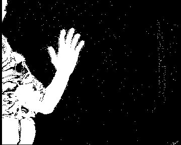

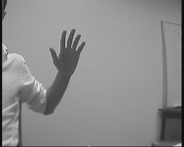

    Output Images:
    //Luma Image Output of ExtractReduce_Y function
    //Background Subtraction output Image (p_img_dst on tne DSP code)
    //Connected Components output of  VLIB_createCCMap8Bit (p_img_dst 2 in the DSP code)
    Thanks in advance.
    Best Regards
    Filipe

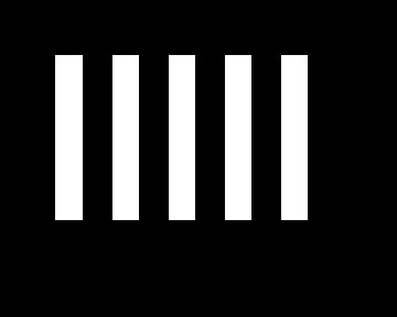

  • Just a few more info to share:
    I have made another test,
    this time i have created a static image:
    unsigned char image[288][360];
    then created this pattern with the next function:
    memset(&image[0][0],0,frame_size*sizeof(unsigned char));
     x=0;
    for(i=50;i<200;i++) {
               for(j=50;j<300;j++) {
                         if(x<25)
                                 image[i][j]=255;
                         else
                          image[i][j]=0;
              if(x>50)
                        x=0;
             x++;
    Next i packed the img
    VLIB_packMask32(&image[0][0],
                p_img_fg_pack,
                frame_size);
    And fed p_img_fg_pack to the  VLIB_createConnectedComponentsList
    The output of VLIB_createCCMap8Bit is has next.
    The number of components extracted from VLIB_getNumCCs is 23 what is in accordance with the output of VLIB_createCCMap8Bit
    This allows us to trace the problem to the VLIB_createConnectedComponentsList.

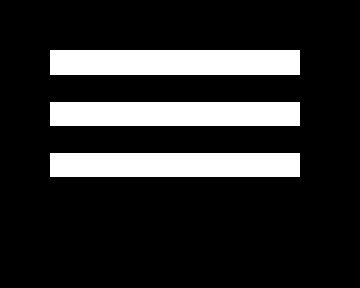

    For another test case:
    output:
    I would point to the frame_width and frame_height or to the memory layout of the input image. But it seems correct to me.
    Best Regards
    Filipe,
    Firstly I want to check whether its a problem with the VLIB algorithm or it is with something else.
    Usually it would be difficult to debug the algorithm within a system framework. So lets try to check whether this code works fine on a simple project and make sure it is not a problem with the algorithm.
    It looks like you are getting a correct background subtracted image. So I am assuming the code above connected components call is working fine.
    Could you please send me a uncompressed version of the output binary image? The JPEG file attached here has some compression artifacts.
    I will test the connected components algorithm with this image.
    Senthil
  • Hello Senthil,
    I am pleased to let you know that my  problem is solved.
    I would also like to thank you for your will to help in this case.
    The problem i think was in dimensions of my image. Has the original from the camera was 720x576 i sampled it to 360x288.
    360 "is not divisible" by 32 or 64, this could mean that the pitch was wrong. The background Subtraction algorithm worked well cause it only sees 1 pixel at time. The connected components needs to analyse neighbour pixels, and therefore it needed the width/pitch. Somehow i believe the value of the width must be divisible by 64 (but i think this was not informed, on the other hand in the Erosion/Dilation it was explicity refered). i havent tested this for others values to really confirm if the width must be 32 or 64 divisible.
    Best Regards
  • Filipe,
    Thanks for the appreciation.
    I am glad that you could solve the issue.
    Now I understand why the output pattern looks like the ones you shared.
    It looks like VLIB_connectedComponents indeed assumes the width to be a multiple of 32.
    So how did you get it working now when your image width is not a multiple of 32?
    Senthil
  • Hi ,
    I took the easy approach and resized my image to 640x480, or better, 320x240.
    The hard approach i guess would be to pad all the image lines to a 32 divisible width.
    Anyway it was worth sharing that while i was doing tests trying to solve the problem there was a time that it worked well.
    At that time instead of using the packed foreground image mask that i dynamically allocated has a 1 dimension buffer, i declared statically  a 2 dimensions array has used in the VLIB example. I could not use the VLIB_packMask32 to pack my image, but used the pack "function" that also comes with the example, and at that time it worked.
    Maybe by being a 2 dimension array, the layout in memory puts each width starting at a 32 multiple offset, i dont know exactly why it worked.
    By the Way, while doing the resize of the image, i used the DMAI Resizer, the output image for example for 320x240 is really, really bad. I read something about the coefficients that need to be changed and optimized for each different resize options. My question is, isnt that the job of the DMAI resizer?
