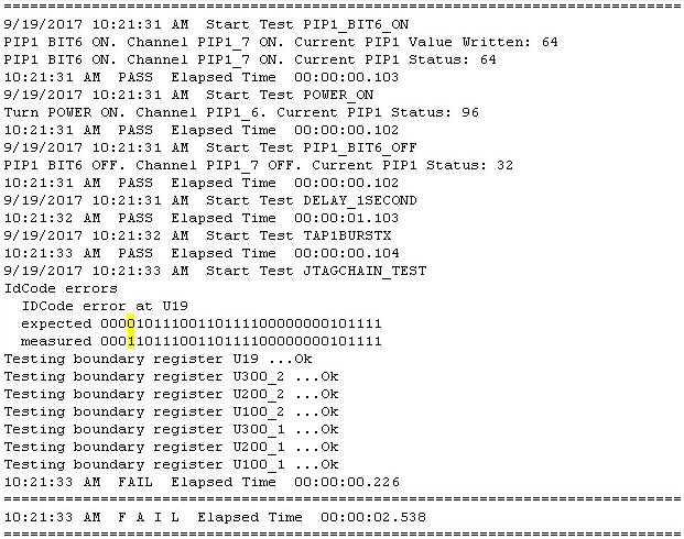

I encountered an IDCode error when using BDSL with CasCON software (Goepel).
Please advise why there is a difference and how to resolve this.

The first four bits of the IDCode represent the variant of the device. It appears you are using the AM571x ver 1 as shown in Table 1-5 of the TRM. The BSDL did not change between ver 0 and ver 1 with the exception of the variant field so a new BSDL was not published. You need to edit your BSDL file to change the variant field.

attribute IDCODE_REGISTER of AM571_top : entity is
-- version, part number, manufacturer code of ti, lsb
"0001" &
"1011100110111100" &
"00000010111" &
"1";
