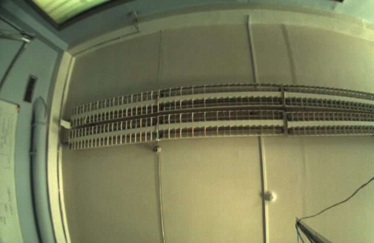

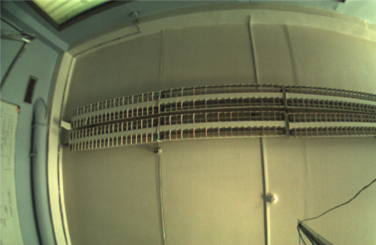

  • I see that you have done something that I can not now.
    I'm trying to take c MT9V032 raw 8-bit data, I manage it, but it seems that does not work preview engine. Tried source CCDC and SDRAM, but all in vain.
    Here is the RAW image data (correctly):
    Here YUV (not correct)
    Thanks & Regards.
