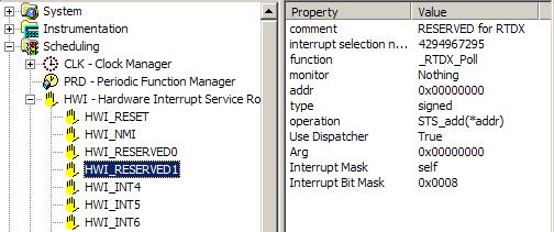

  • There are 16 hardware interrupts but four of them are reserved (INT0 is RESET, INT1 is NMI, INT2/3 are reserved for RTDX). I am not sure why this document does not include the two reserved interrupts for RTDX, but there are indeed two more to round out the full 17 outputs.
    If you don't mind please submit this feedback by clicking the "Submit Documentation Feedback" at the bottom of every page of that document.

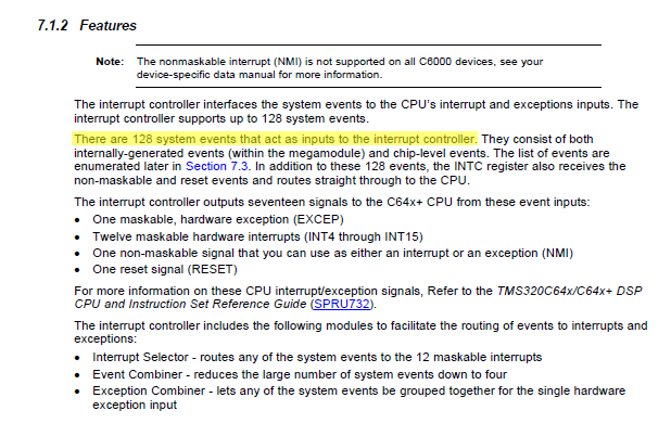

    Where did you come up with 15 inputs?  It says in that same paragraph that there are 128 inputs.  I'm attaching a screenshot.

  • Brad,
    I think he meant the 15 system interrupts to the CPU listed in his earlier post (12 maskable, reset, nmi, exception). Quoted from p158 of SPRU871J:
    The interrupt controller outputs seventeen signals to the C64x+ CPU from these event inputs:
    · One maskable, hardware exception (EXCEP)
    · Twelve maskable hardware interrupts (INT4 through INT15)
    · One non-maskable signal that
    · One reset signal (RESET)
    As you can see it only lists 15 signals, not the full 17 (it's missing the two reserved for RTDX).

  • I'm not exactly sure what their purpose is, but there are two hardware interrupts reserved specifically for some RTDX functionality not related to the mappable TX/RX interrupts. See the attached screen capture from a BIOS configuration file. These two events are not described in the document, but they are definitely there and are not maskable.
