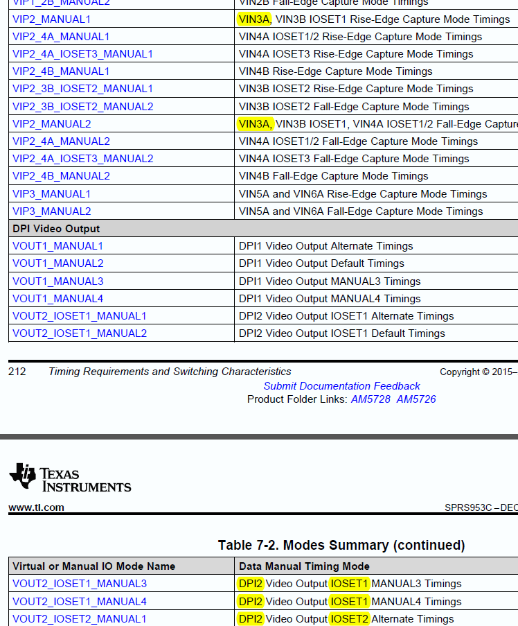

    It is not about changing the tool, the tool works as intended because configuring the pins outside IOSET spec is a nono. Not to mention VINs and VOUTs get even deeper because the manual delay modes that you need to configure are tightly coupled with their iosets. How are you planning to meet the timing and delay requirements to ensure proper operation of the device? See below excerpt form DM:
    Why did you not follow the DM? Did you have a schematic design restriction or something?
