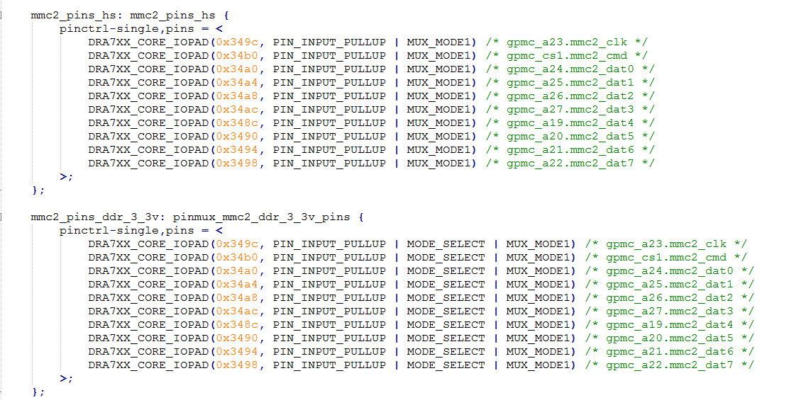

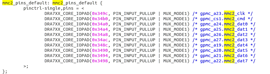

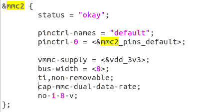

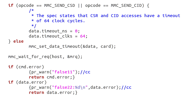

Hi all,
We've made a custom board according to 5728 evm board but we use different emmc.As show in the following picture,evm use the Kinston emmc and we use the micron emmc and it supposed to be compatible.
However,our custom board can't run the emmc in the right way,the dmesg file is showed below(mmc1 is emmc)

I've try to add some debug information to locate where the problem is and now i find that the error maybe in the mmc_ops.c file our board return err=-84 and evm return 0 which is correct
and the err cause our borad can't switch to bus width 8 in the file mmc.c
In all,i am still confused where the problem is and wondering if someone can provide more insight for me on this!

    Can you post the eMMC nodes, as well as pin mux information, from your DTS file?
  • Hi RonB,
    I am not sure how to view the U-boot log you need,but i have tried to switch to mmc1 in u-boot and failed,mmc1 can't be the current device so i can't read or write in u-boot either.I use the fdisk -l command and get error following

    I haven't tried lowering the clock speed,i'll try later.
    The eMMC nodes and pin mux info i used is as same as the evm board,I use the default settings,however,i've tried different pin mux settings(mmc_pins_hs and mmc_pins_ddr_3.3v) and it didn't affect the issue
    I thought that the eMMC has been recognized because it shows the size of the eMMC,it that correct?
    [ 3.358343] mmc1: new high speed MMC card at address 0001
    [ 3.358674] mmcblk1: mmc1:0001 Q2J54A 3.64 GiB
    [ 3.358825] mmcblk1boot0: mmc1:0001 Q2J54A partition 1 2.00 MiB
    Sorry for my bad english,and i don't know much about how eMMC works,so if u have anything not clear, just tell me.
  • Hi RonB,
    The problem is solved.It turns out that there is nothing wrong in software,it 's a hardware problem.
    Thanks for your help
