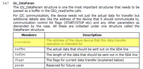

I did not find where to set the slave device (here they are AIC31 and that for mmcsd part) address.

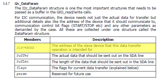

        dataBuffer.slaveAddr = deviceId;
        dataBuffer.buffer    = &data[0];
But i don't known when function aic31I2cRead() was called in audioSample.pjt and how the parameter deviceId was passed.
is this deviceId the same as that "device id" which is set during create user defined device object i2c0 in Tconf?

    Any device that sits on an I2C bus has a corresponding address.  This information would be found inside the data sheet of the given device (e.g. the audio codec, etc.).  Often there are configuration pins to allow you to modify 1 or 2 bits of the address (i.e. for support of multiple devices).
    For the MMCSD i2c initializations refer to the file "mmcsd_evmInit.c".
    For the AIC31 address are taken directly by the codec driver. If you need to modify the slave addresses refer to the "Aic31Local.h"
