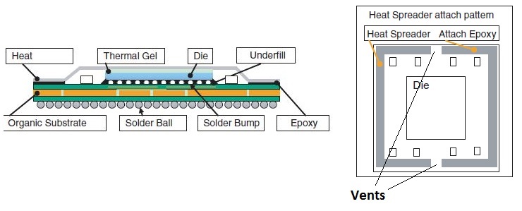

I understand that the AM5K2E04XABDA4 package is a 1089-pin flip-chip BGA. I can't find if this part is vented. I need to include specific notes in my build file if it is vented.
Please verify that the AM5K2E04XABDA4 package is vented.
Jared,
I am not familiar with a need for venting. I believe that the spaces between the substrate and die and between the die and lid are fully filled. Does this answer your question?
Tom
Tom -
I am interested in whether or not the lid is completely sealed to the substrate or if there is a capability of air to flow between substrate/die and the lid.
Sometimes vent holes are added around the lid epoxy to ensure moisture ingress and egress in the laminate construction. They help avoid moisture buildup and outgassing in the cavity between the substrate/die.
I believe what you are saying is that there are no vents but I want to make sure.
Jared,
Once I tracked down the proper expert, that confirmed that your assumption was true. The device is vented.
Tom
