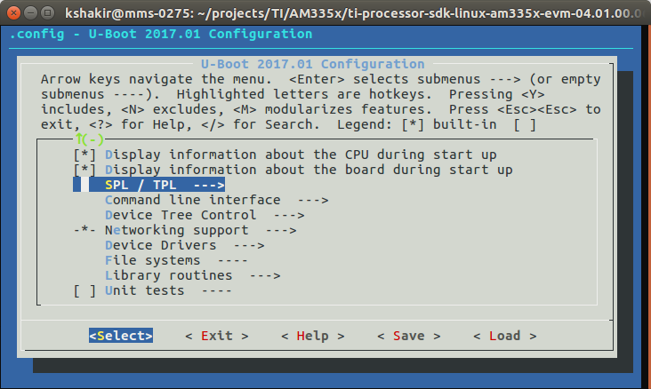

Hello everyone,
I'm trying to bring up a custom board similar to the BBB with the AM335x and I can see the steady "CCCCC".  Because of a different RAM (Micron MT41K256M16HA-125:E) on my board as on the BBB, I followed these wiki:
_processors.wiki.ti.com/.../Sitara_Linux_Training:_Tuning_the_DDR3_Timings_on_BeagleBoneBlack
in the newest SDK for am335x-evm. When I create an sd-card, I only see this in the terminal:
"U-Boot SPL 2017.01-g590c7d7fe1 (Sep 26 2017 - 18:28:01)" at boot.

  • Hello Eric,
    When you #define DEBUG in am335x_evm.h didn't you got the u-boot-spl section `.data' will not fit in region `.sram' error?
    Kemal

  • "dirty" means that you have uncommitted changes in git. Can you put the #define DEBUG under #define CONFIG_AM33XX and retry?
  • Hi Kemal,
    I put it after #define CONFIG_AM33XX but the result is just the same.
    Here are my steps, maybe I just missed something?!

  • `.rodata' will not fit in region `.sram' - you have to run ARCH=arm make menuconfig go to SPL / TPL section and remove some features from MLO to fit the .rodata in .sram
  • Hello Kemal,
    could you please be a little more specific?
    What do you mean by menuconfig?
    Which features should I remove without getting new problems? I couldnt find anything about this in the uboot board port section.
    Thank you for your advise.
    Kind regards
    Eric
  • Remove the features which you don't need and other configurations doesn't depend on it.
