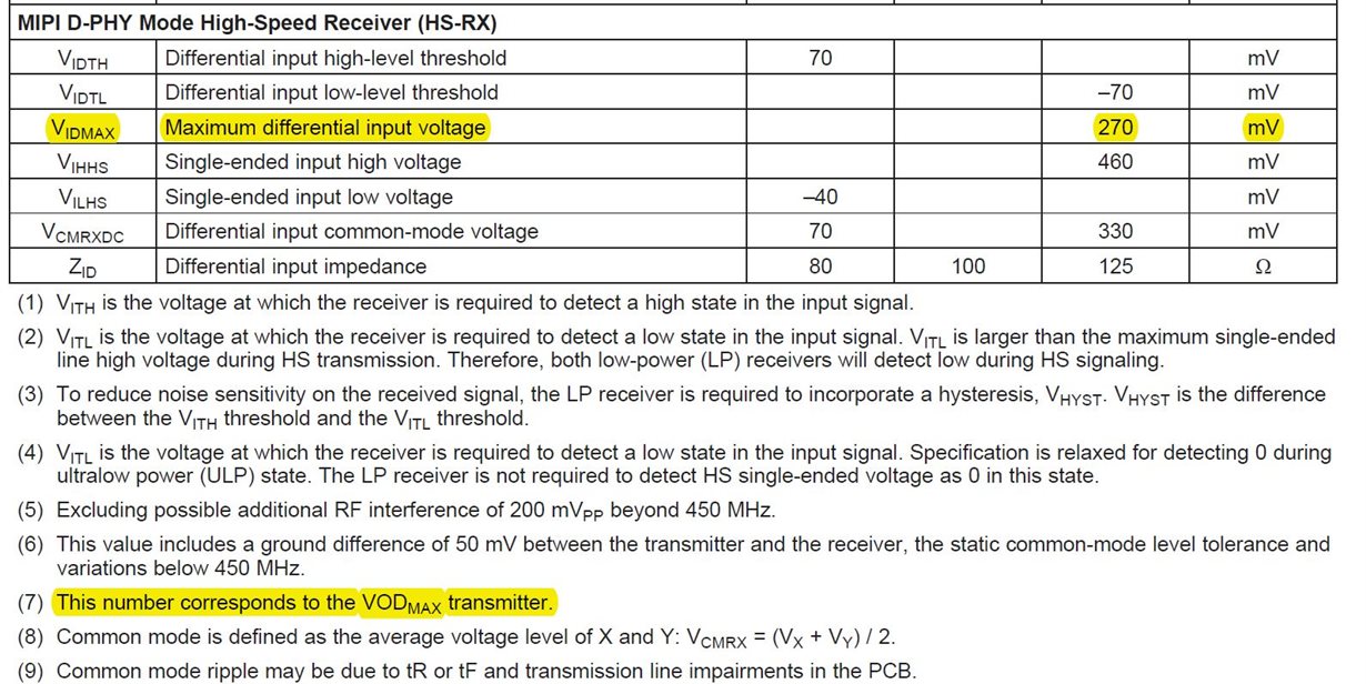

I would like to confirm the meaning of VIDMAX of electric specification of CSI2. This is described in the data manual as follows:
Does this value correspond to annotation (7), meaning the same value as VODMAX on the sending side?
Or, does it mean that the differential amplitude is 270 mV as the reception specification of CSI2?
In the latter case, the maximum value of CSI transmission specification is 270 mV as a standard. So, considering the reflection on the transmission line etc, we are worried that TDA3x can not connect with MIPI standard device.
