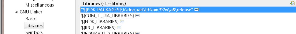

  • Let me try and help based on the feedback you have provided here:
    For XGCONF/RTC/XDCTools usage, TI RTOS OS kernel has been designed to be used with XGCONF so that the appropriate module in the SYSBIOS kernel can be added and removed from the .cfg file. However, the PDK library which is the device specific drivers, low level register defines and board libraries don`t  necessarily require XDCtools, they can be linked and included similar to any other library.
    Now, let us look at CCS project creation and look at the Macros that you refered to. TI SDK uses setup environment scripts, CCS Product discovery and pdkProjectCreate script to generate the CCS projects, these scripts are created to pick up macro definitions based on where you have installed the SDK.
    When you are creating a project in CCS, if you want to create portable projects that you can share with other, you can define similar macros by right clicking on the project and going to Build Properties. Under properties, you can define your own variable like PDK_PACKAGES as shown below:
    For headers files that are included in the PDK, you care only recommended to add ${TI_PDK_LIBRARY_PATH} to the CCS Build- > GNU Compiler- >Directories
    In the source include path relative to the packages folder:
    /* UART Header files */
    #include <ti/drv/uart/UART.h>
    #include <ti/drv/uart/UART_stdio.h>
    #include <ti/drv/uart/test/src/UART_board.h>
    To link the libraries, go to the CCS BUILD -> GNU Linker- > Libraries.  Add library search path :
    and add the  driver library using the following ssyntax
    Note:  For GNU compiler , you need to add colon infront of library names that don`t start with lib as explained here:
    http://processors.wiki.ti.com/index.php/Processor_SDK_RTOS_FAQ#How_to_create_ARM_baremetal_CCS_project_that_link_to_PDK_driver_libraries_using_GNU_Linker.3F
    Note: Board library, drivers may have dependency on other libraries so you need to include other libraries as required.
    For Example board library has dependency on csl, uart, i2c, osal drivers so those libraries will have to be added in the same way. When getting started, I will start by creating a project where all driver libraries, board and OSAL library are linked, the linker will eliminate symbols that are not used. Note when using OSAL, you need to select whether your application will use RTOS or will be bare metal and link library appropriately.

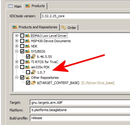

    But this does it explain why, if I add the PDK to the projects setting, variables are not added automatically.  And why I have to define it myself?
    Or where those ones come from that are not defined anywhere?
    What's the point of checking that "am335x_PDK" box if it doesn't do anything?
