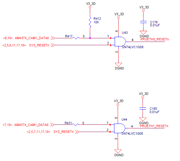

I am migrating the EtherCAT + EnDAT project from AM437x Industial EVM (version 1.4A) to my custom board.
The custom board is designed following the circuit of AM437x Industrial EVM, reducing peripheral module to EnDat, QSPI(for flash) and ICSS Ethernet port.
I am facing the problem that when the custom board execute BOARDGetDeviceCtrlModId() function in board_platform.c, it will jump to _exit() immediately.
Since the EtherCAT + EnDAT project on EVM board have UART and Industrial I/O circuit which custom board don't have.
Is this problem cause by the incorrect pinmux configuration?

    I found the similar issue on E2E community (https://e2e.ti.com/support/arm/sitara_arm/f/791/p/600426/2211180?tisearch=e2e-sitesearch&keymatch=MDIOPhyRegRead#2211180 )
    On the AM437x EVM and custom board, there is a PHY chip reset circuit using SN74LVC1G08.
    Because of the late delivery time of SN74LVC1G08, this chip is not placement on the custom board during the production.
    I have tired to short the AM437X_CAM1_DATA6 pin to PRUETH1_ERSETn and PRUETH0_RESETn, but this is not work.
    Since SN74LVC1G08 will arrive next week, I will continue the test on next week.
    Many Thanks.
    Yi-Lin
  • Hi Eric,
    I have put SN74LVC1G08 chip on custom board, but it still get stuck at while-loop in  bsp_tlk105_init() function.
    while(!MDIO_getPhyIdentifyStat((((PRUICSS_HwAttrs *)(
                                             pruIcssHandle->hwAttrs))->baseAddr + PRU_ICSS_MDIO), phy0addr, NULL))
    The PRUETH circuit is designed following AM437x IDK without any change.
    So I think PHY address of two TLK105 should be correct.
    Is there any suggestion for me to figure out how to solve this problem?

  • Hi
    I still stuck at the bsp_tlk105_init() function.
    And I found there is something weird when executing HW_WR_REG32() function in MDIOPhyRegRead (mdio.c line90)
    Since "baseAddr" and "regVal" value are "0x54432400" and "0x80400000"
    After executing HW_WR_REG32() function
    void MDIOPhyRegRead(uint32_t baseAddr,
                        uint32_t phyAddr,
                        uint32_t regNum,
                        uint16_t *pData)
        uint32_t regVal = 0U;
        /* Wait till transaction completion if any */
        while(MDIO_USERACCESS_GO_EN_0x1 ==
            HW_RD_FIELD32(baseAddr + MDIO_USERACCESS(0U),
            MDIO_USERACCESS_GO));
        HW_SET_FIELD(regVal, MDIO_USERACCESS_GO, MDIO_USERACCESS_GO_EN_0x1);
        HW_SET_FIELD(regVal, MDIO_USERACCESS_WRITE, MDIO_USERACCESS_READ);
        HW_SET_FIELD(regVal, MDIO_USERACCESS_PHYADR, phyAddr);
        HW_SET_FIELD(regVal, MDIO_USERACCESS_REGADR, regNum);
        HW_WR_REG32(baseAddr + MDIO_USERACCESS(0U), regVal);
    The register value at 0x54432480 will be 0x20402000 not 0x80400000 on AM437x IDK
    But on custom board the value will be 0x0040FFFF, which will not pass the if statement in MDIO_getPhyIdentifyStat() function (osdrv_mdio.c line509)
