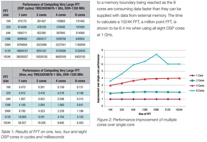

I can't achieve same characteristics which were performed in document "Very large FFT for TMS320C6678 processors". I have next results fo FFT 1024K:
8 Core: 32.484165 ms vs 6.403 ms in document;
4 Core: 35.519242 ms vs 9.605 ms in document;
2 Core: 58.152080 ms vs 19.328 ms in document;
1 Core: 115.402698 ms vs 38.557 ms in document.
