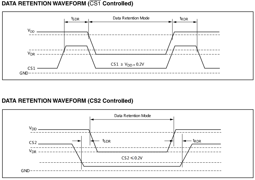

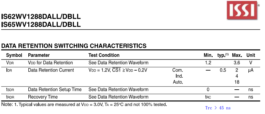

hi,TI experts
I have a chip named IS62WV1288DBLL-45QLI which is a SDRAM need to be linked to the am335x gpmc, I look at the kernel code and did not find the relevant driver , is there any relevant information can refer to?
