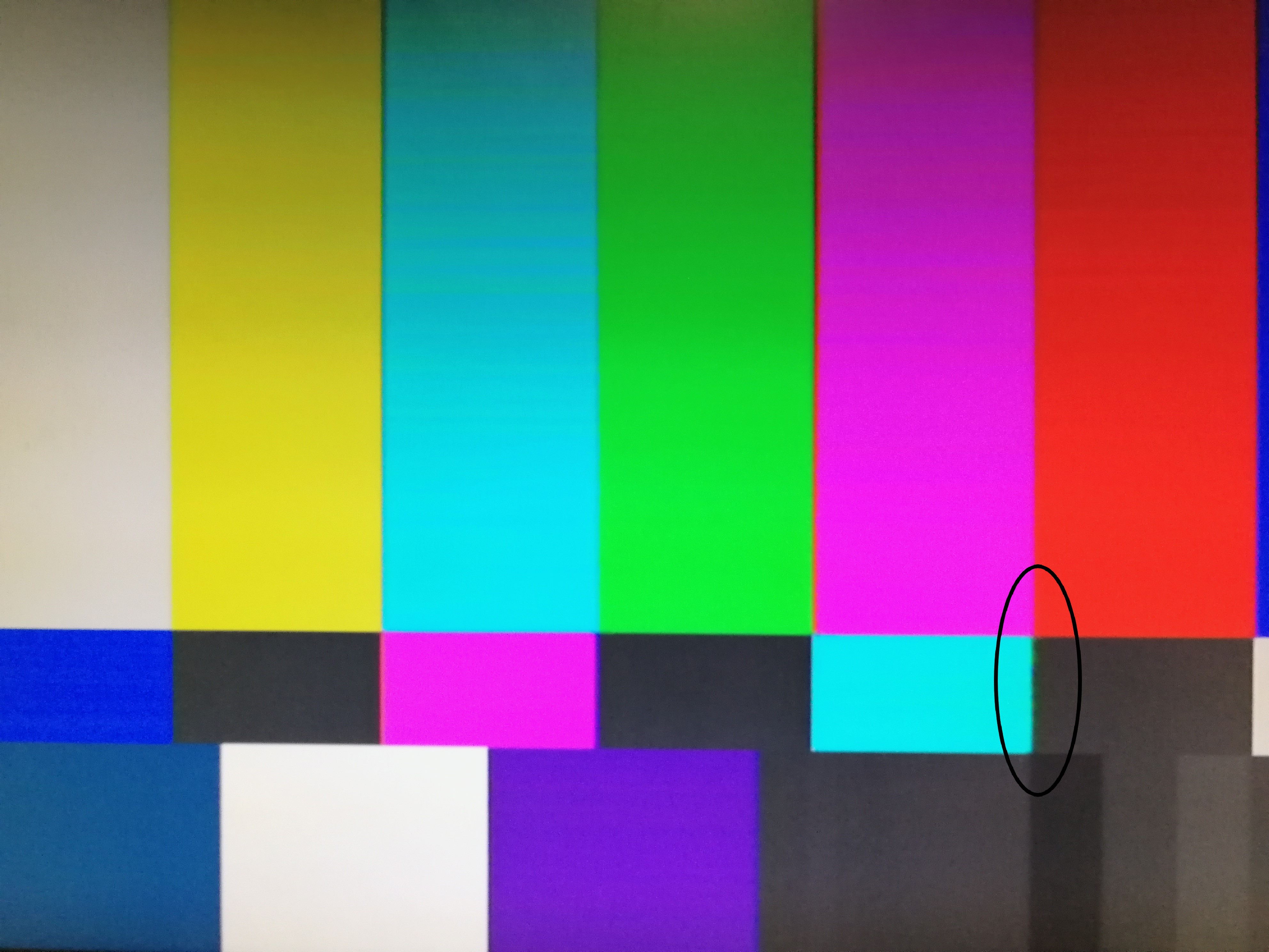

I've got some picture,but there's something wrong with the picture.
I checked the waveform with an oscilloscope.I got a waveform with 480p.I don't know how to configure the LCD1 in interlace mode.
My SDK is 3.0.0.4.

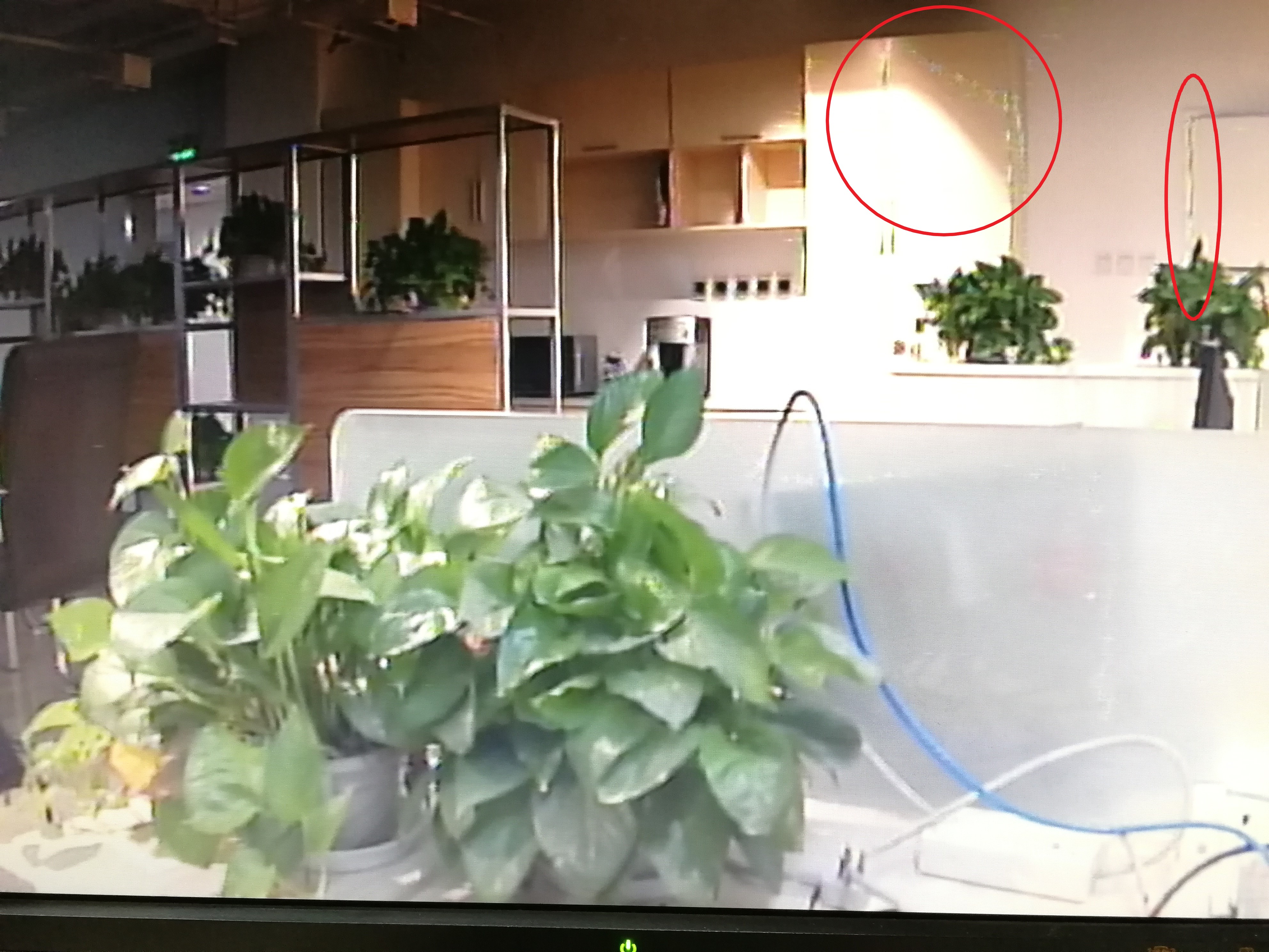

    But there is another issue happened.

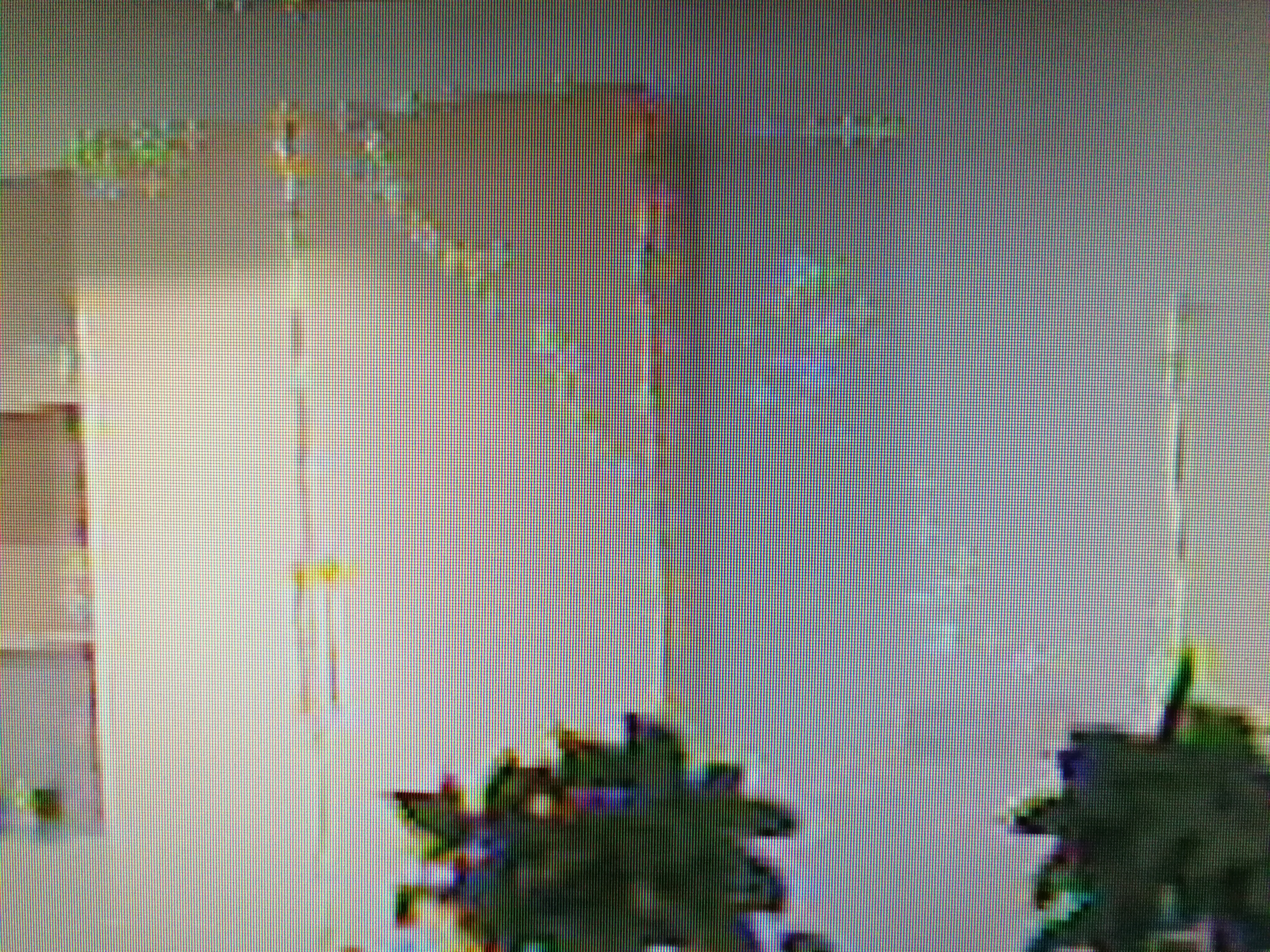

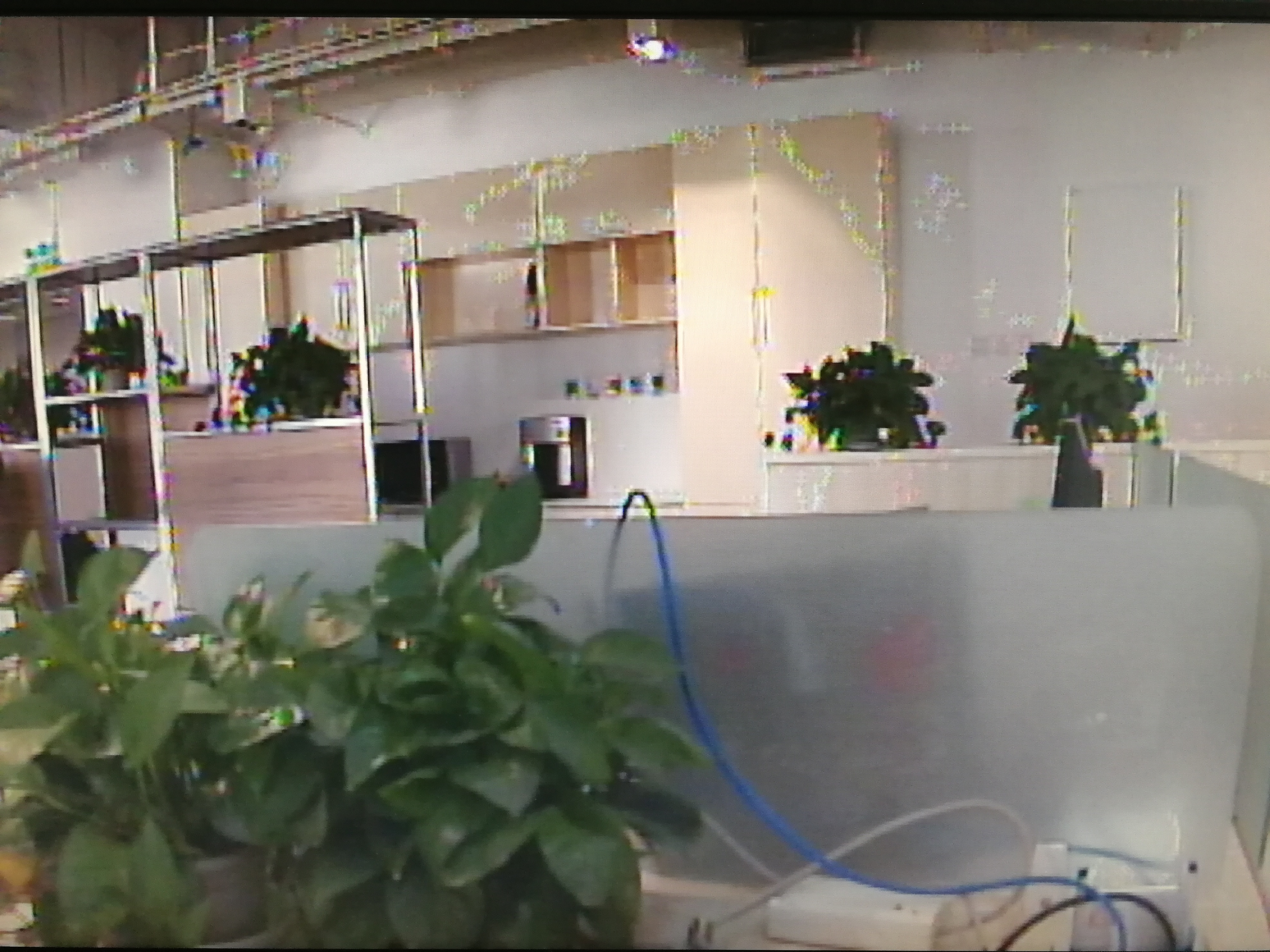

    There is some noise inpicture.
    I try to Lower the brightness in dispc.c ()
    const struct color_conv_coef ctbl_bt601_5_ovl = {
    /* YUV -> RGB */
    298, 409, 0, 298, -208, -100, 298, 0, 517, 0,  => 130, 409, 0, 130, -208, -100, 130, 0, 517, 0,
    //ry , rcr, rcb, gy, gcr, gcb, by, bcr, bcb;
    The noise will be reduced.But not disappear.
    bulabula_yan
  • Have you investigated at what stage the noise getting introduced? You need to work on the source of the noise introduction and not masking it.
    Can you share video processing data flow, starting from the source to end display?
  • I froget to say , this issue occurred in the output stage(dss driver?).
    My source is  YUV422 and I'm going to output RGB24 with LCD1.

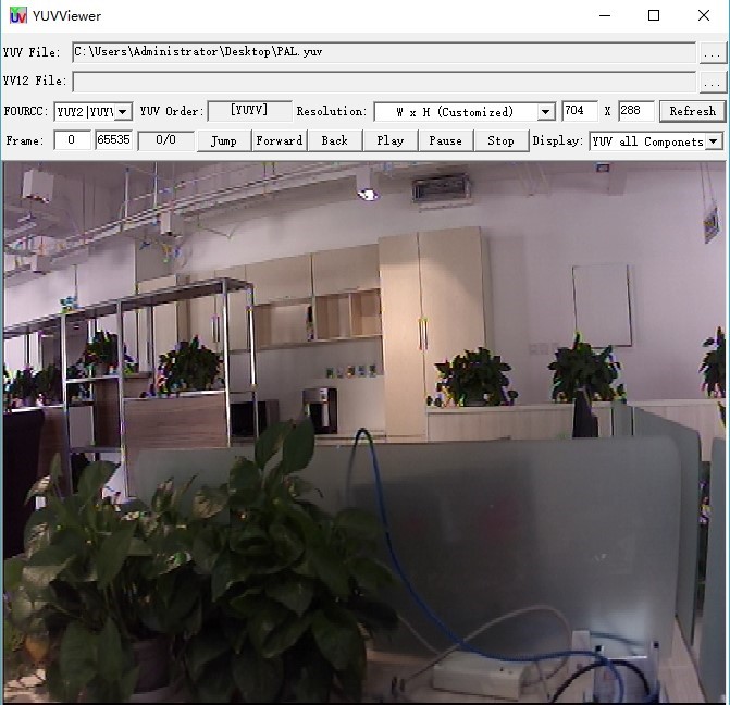

    Here is the picture I capture from v4l2(one field).There is no noise in picture captured from VIP.
    PAL.zip

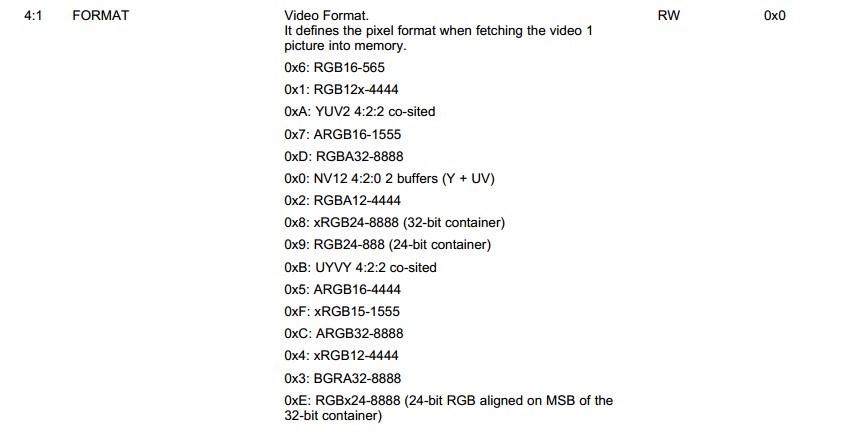

  • I would be interested to know what all processing invoked on display. Other then YUV422 to RGB24 conversion, what other processing happening on display? One field input of what resolution and what's the display resolution - trying to understand scaling involved? Any thing?
  • I just use :
    dmabuftest -s 31:1408x288 -c 704x288@YUYV -d /dev/video2
    or
    v4l2capturedisplay -s 31:1408x288
    I think there is no more process,it's just capture and display.
    Like what I said above,PAL needs 2 clocks to capture 1 pixel.So I change LCD timing from hactive = <704>  ==>  hactive = <1408>
    I think the scaling is involved.
    I use to omapdrmtest / v4l2capturedisplay to do scale myself(1 pixel to 2 pixels).It still has this peoblem.
    Blow is my test code and the picture I got

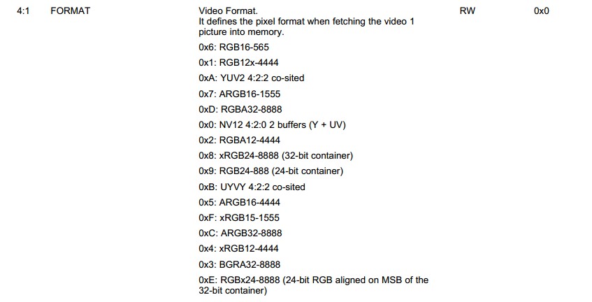

    I add printk() in dispc_ovl_setup() to read register from AM5728.
    I find that  DISPC_VID1_ATTRIBUTES is 0x2a08211.
    DISPC_VID1_ATTRIBUTES[ 4:1 ] is 0x8 .
    Is that right?
    I think 0x9 is the correct configuration.I have configure : data-lines = <24>;
    How can I configure to RGB24?
  • Hi,manisha
    The issue is still happening.Please help us .
  • I tried modetest command:
    modetest -ds 31:1408x288@RG24
    [ 3053.107634] ***** DISPC_OVL_ATTRIBUTES   is 2a08a13******
    [ 3053.113069] ***** DISPC_OVL_ATTRIBUTES2 is 0******
    There is still a little noise but it happening on the edges of different colors.
  • Is it possible to remove ADV7343 from the equation and some how replicate the issue on GP EVM? I do not see any artifacts with dmabuftest on GP EVM LCD panel display.
    Thanks for reply.I find the mistake.The pixelclk-active = <1> in dts file means falling edge to capture.
    I was wrong about that.I need the rising edge clock.
