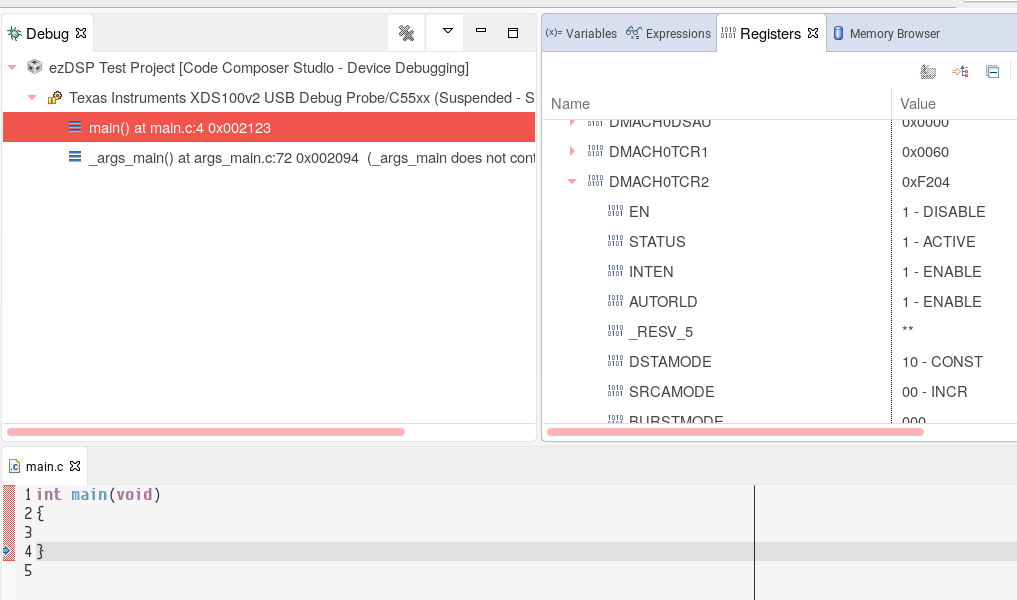

For example, looking at the register browser, the DMA transfer status (DMACH0TCR2 STATUS) seems "stuck" at 1 - no matter how many times I reset, restart, reprogram or even unplug and replug the USB cable. Same for the CPU register BERR (bus error).
I have stripped my code down to nothing more than:
int main(void) { return 0 }
I try resetting the CPU, restarting it, filling the memory with 0. I've also tried writing firmware to write to certain registers to reset them, but nope. Changing them in the GUI doesn't have any effect, the GUI control just resets to the unwanted register value. Here's a screenshot of what I mean:

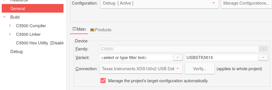

  • The problem was I'd misconfigured the project as bare TMS320C5515 project instead of a USBSTK5515 project. Under the hood, Code Composer Studio loads the appropriate GEL files that tell it how to communicate with the emulator/debugger and how to initialise the device it's debugging.
    I fixed it by manually changing the project properties, under General > Main > Device.

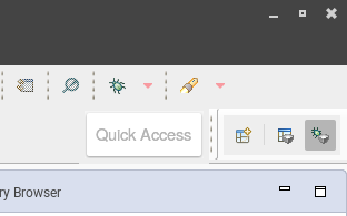

    Then I also went into the debug perspective (don't launch the debug target by clicking on the bug icon, but just open the perspective by clicking on the combination bug/cube icon, usually in the top right).
