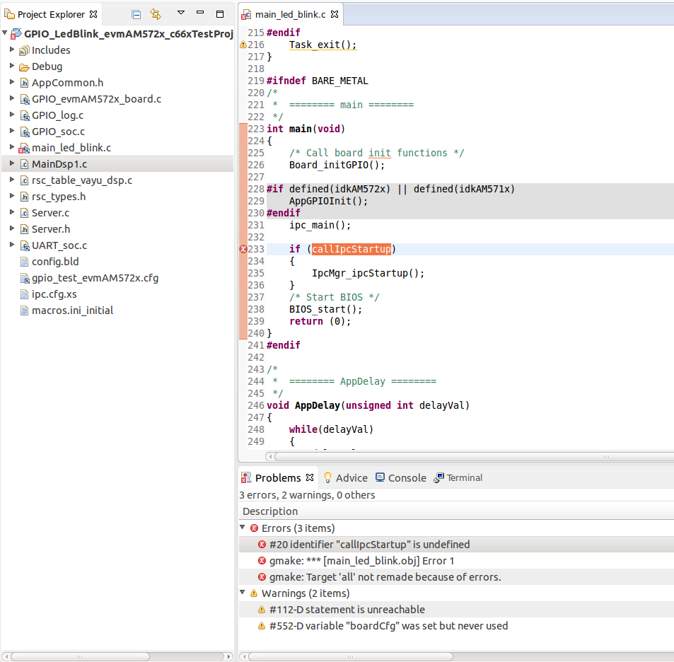

I had followed the section of Adding IPC to an existing TI RTOS application on the DSP of processors.wiki.ti.com/.../Linux_IPC_on_AM57xx to add IPC to the application.
It seems everything has done.I had modified everything except the TODO portion.
And then I got
*** Build of configuration Debug for project GPIO_LedBlink_evmAM572x_c66xTestProject ****

"/home/linyuexin/ti/RTOS-SDK/pdk_am57xx_1_0_8/packages/ti/drv/gpio/test/led_blink/src/main_led_blink.c", line 110: warning #552-D: variable "boardCfg" was set but never used
"/home/linyuexin/ti/RTOS-SDK/pdk_am57xx_1_0_8/packages/ti/drv/gpio/test/led_blink/src/main_led_blink.c", line 216: warning #112-D: statement is unreachable
"/home/linyuexin/ti/RTOS-SDK/pdk_am57xx_1_0_8/packages/ti/drv/gpio/test/led_blink/src/main_led_blink.c", line 233: error #20: identifier "callIpcStartup" is undefined
1 error detected in the compilation of "/home/linyuexin/ti/RTOS-SDK/pdk_am57xx_1_0_8/packages/ti/drv/gpio/test/led_blink/src/main_led_blink.c".
gmake: *** [main_led_blink.obj] Error 1

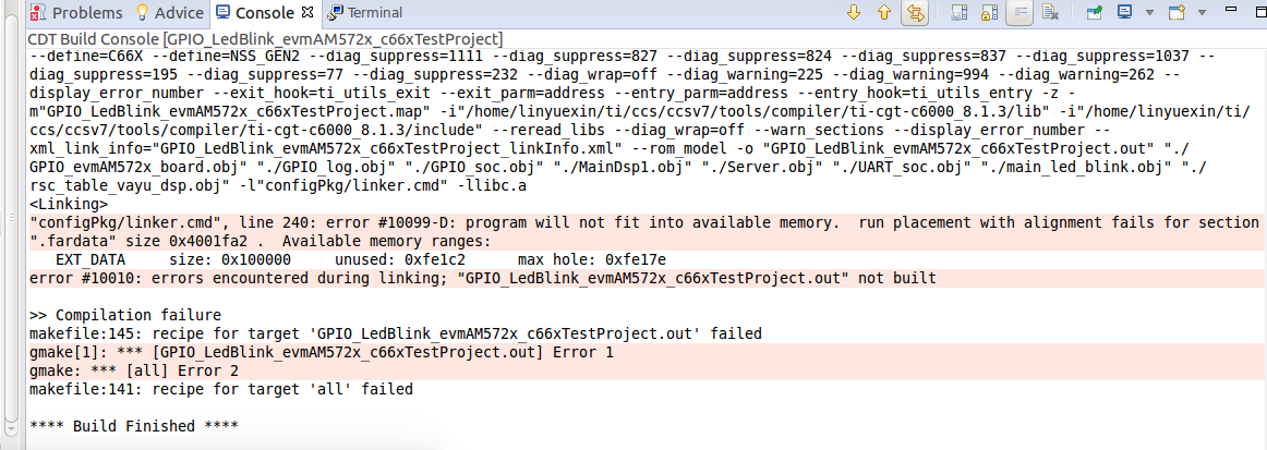

Add:the led blink application could be build sucessfully.
Could someone help me or talk with me?
